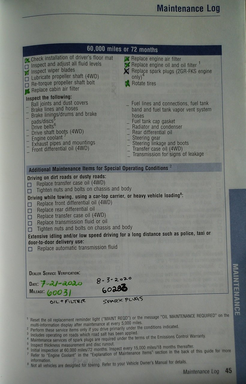

    I just hit 100k on my 2017 Tacoma TRD Sport (DCLB), purchased it new. I have been following the Maintenance Guide that came with the truck and it has never advised to change or flush the transmission fluid except under special operating conditions.
    Mostly highway miles on the truck. I towed a camper for less than 1,000 total miles a few years back and then I recently put a roof top tent on it at 80k miles and only taken off-road to camp. The tent is only on during camping trips, and off for daily driving.
    My question is "What should I do at this point?" :confused:
    It seems some people flush at 60k miles which is recommended under special operating conditions. Some people drain and fill at 100k. Some people never service the transmission unless there is a leak.
    I am a bit disappointed that I didn't think of this until now. If the maintenance guide recommended the service under normal operating conditions, I would have performed the service.

    (Tacoma Maintenance Guide - @ 60k miles to show trans service only under special operating conditions)
