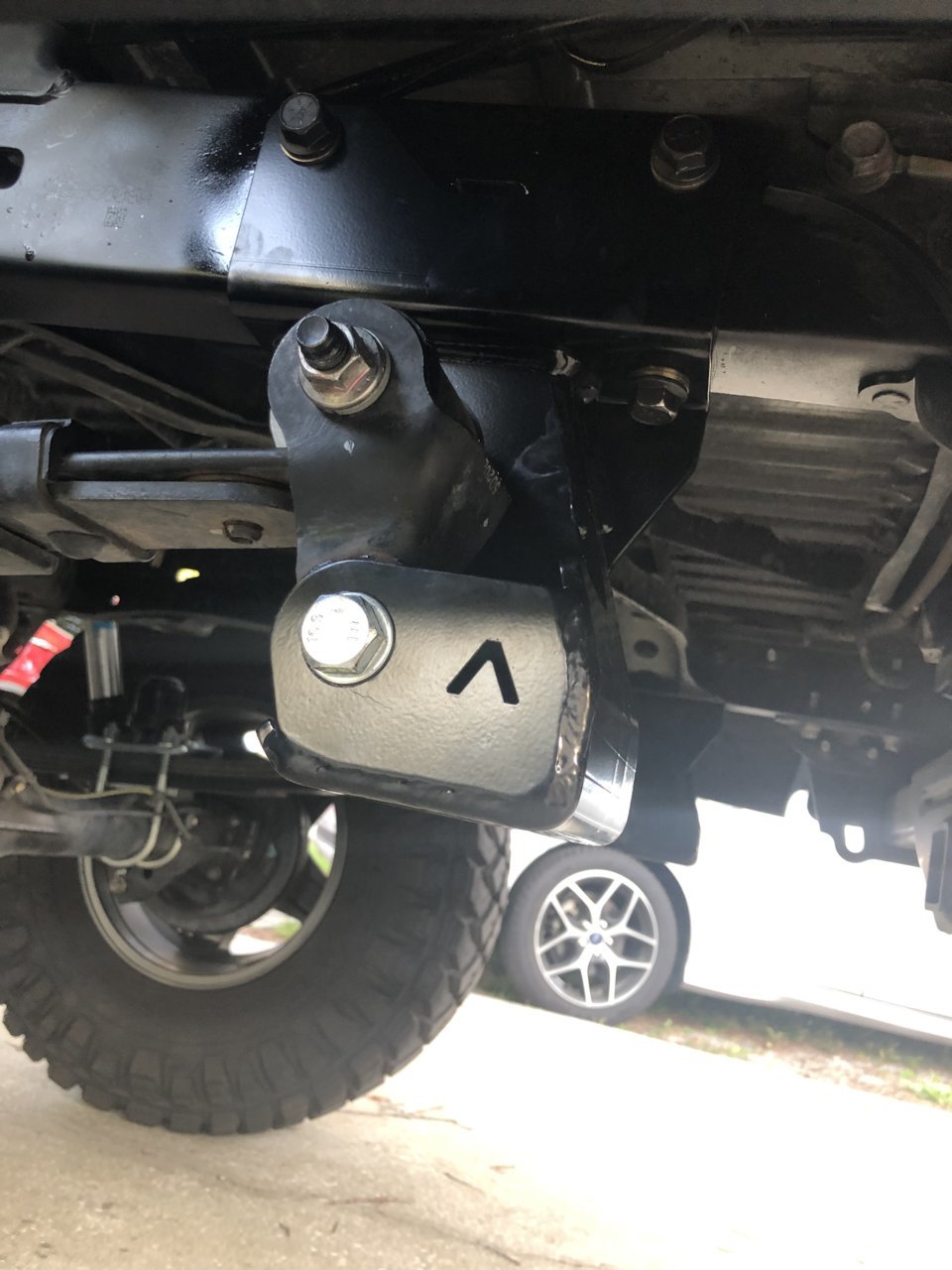

  2. May 10, 2019 at 11:42 PM
    #42
    FlyinRyan893
    FlyinRyan893 [OP] Well-Known Member
    Oct 28, 2015
    #168016
    768
    Orlando, FL
    15 TRDOR DCSB 4X4 6MT
    2" lift. 37s SCS F5s

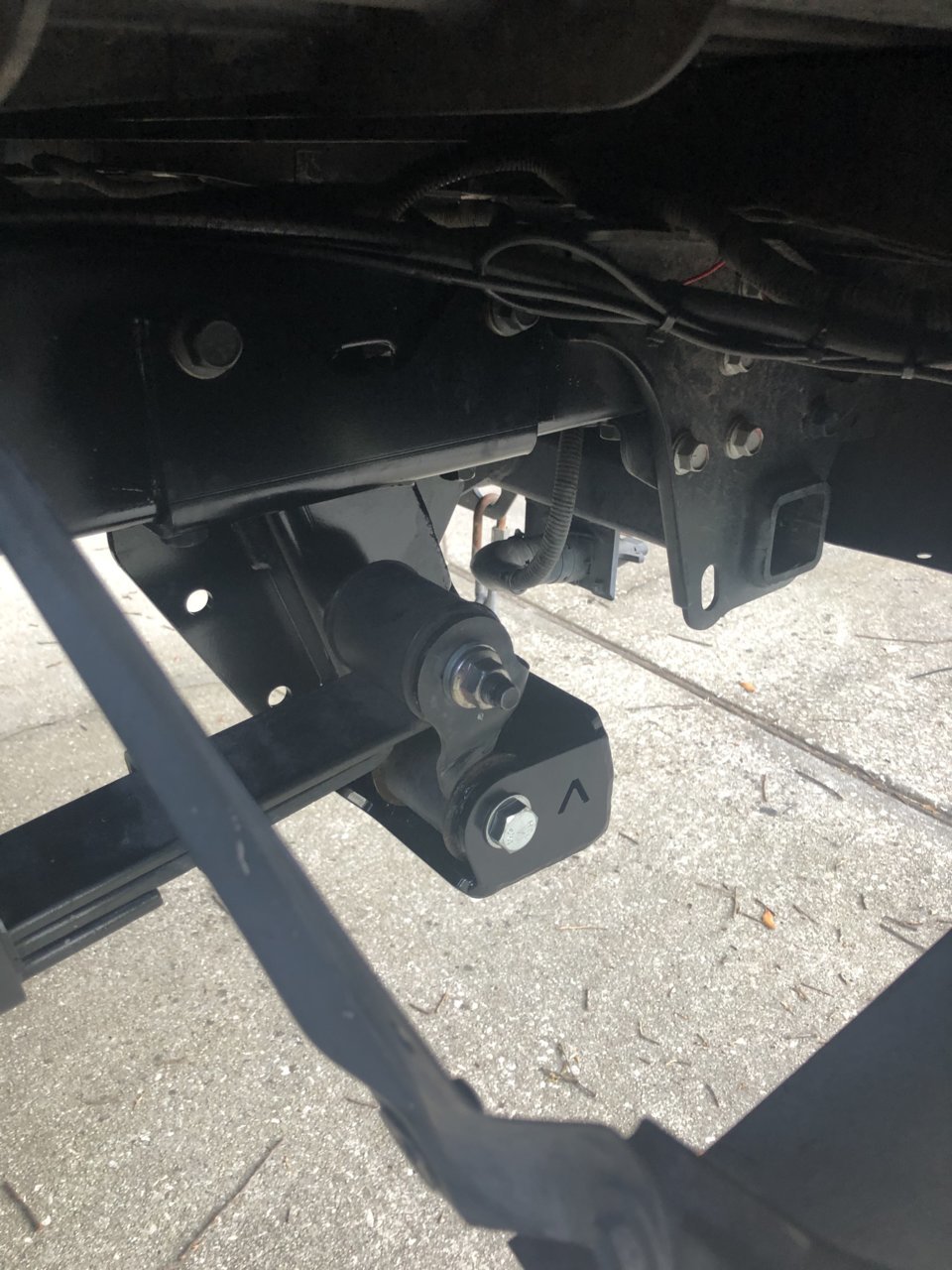

    Finally installed my Archive Garage hammer hangers. Gained maybe 1/2 an inch in rear ride hight. First impressions just driving on the street are great. Rear definitely feels like it’s more flexy. Removing the factory hangers was a huge pain in the ass. Gotta get my extended brake lines installed and then find a spot to flex out on.

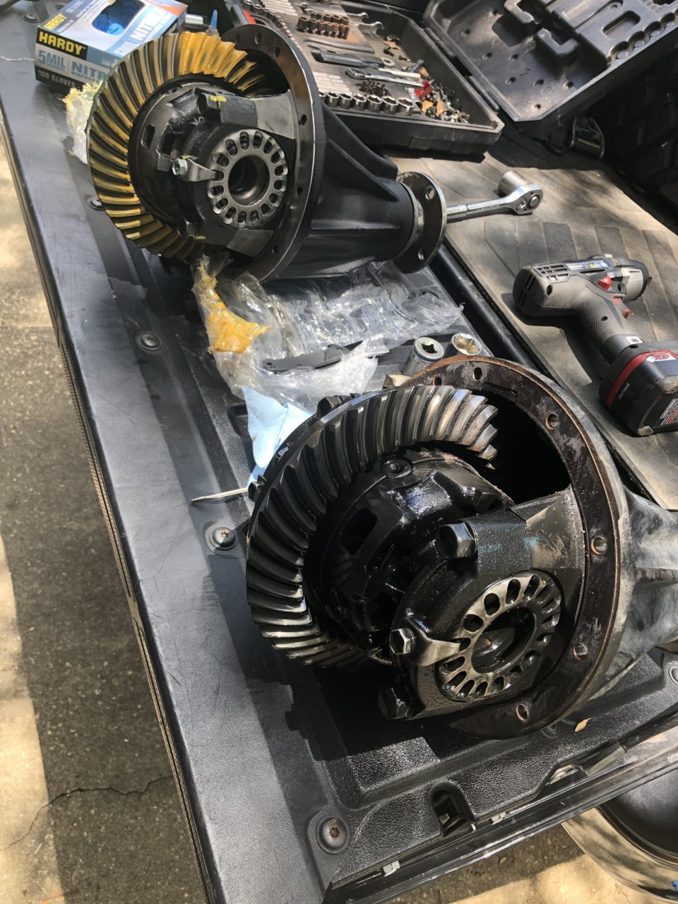

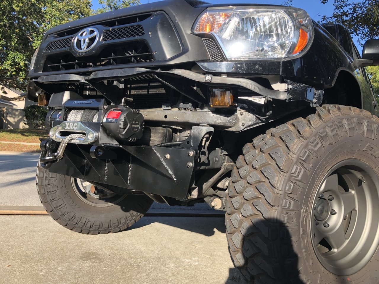

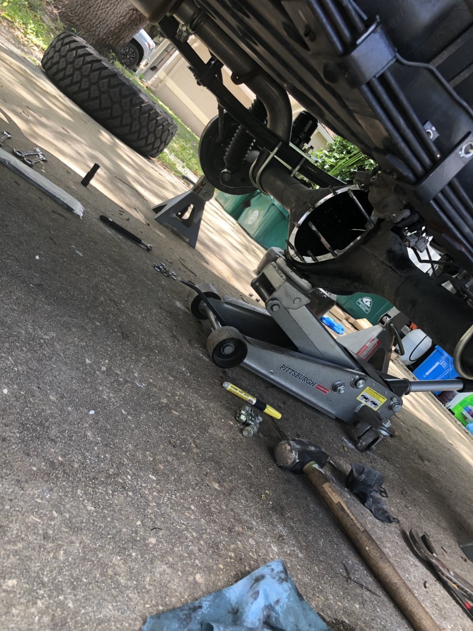

    Swapped my diffs for diffs built by ECGS with 4.56 gears. Started work on a winch mount/ bumper. Should be finished up in a day or so.

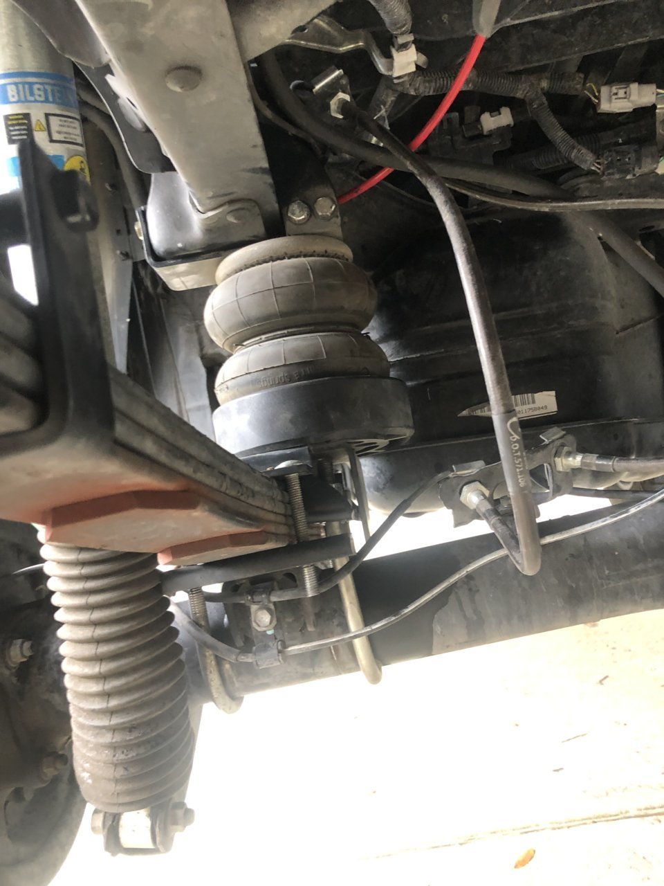

  5. Jun 17, 2020 at 1:56 PM
    #45
    FlyinRyan893
    Oct 28, 2015
    #168016
    768
    Orlando, FL
    Photo dump. Haven’t posted in here in a while. Found out this turd weighs 5300 lbs with 1/2 tank and my fat ass in it.

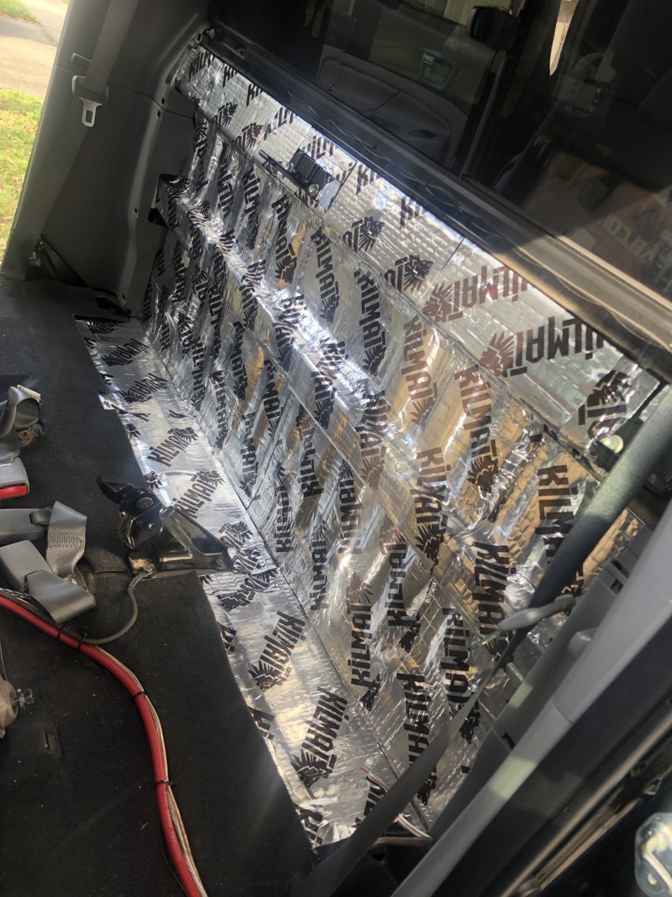

  9. Feb 16, 2021 at 11:33 PM
    #49
    FlyinRyan893
    Oct 28, 2015
    #168016
    768
    Orlando, FL
    Well, after changing companies, taking a big pay cut for the first year, getting furloughed and then recalled, I’m back to modding this thing.
    Sound deadened the back wall and doors. Makes a gigantic difference in road noise and sound quality of my system. Plan to eventually pull the carpet and deaden the entire floor.
    Got a few other minor mods in the works too. Hope to actually go on some wheeling trips this year.

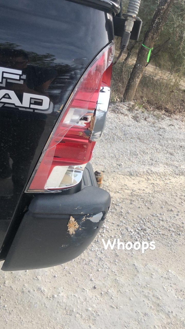

    Smashed my tail light the other day playing in a big washout on a forest road. Probably the lamest body damage I’ve ever taken.

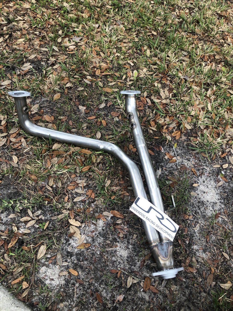

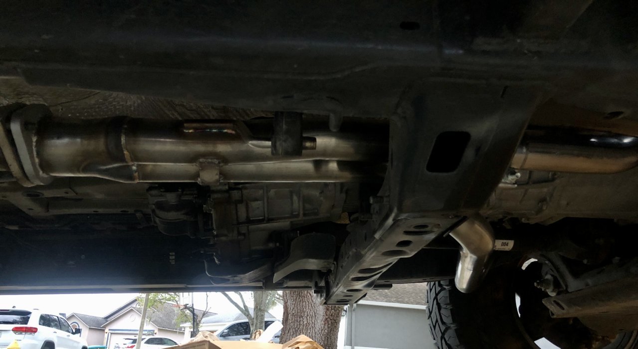

  10. Feb 24, 2021 at 6:32 PM
    #50
    FlyinRyan893
    Oct 28, 2015
    #168016
    768
    Orlando, FL

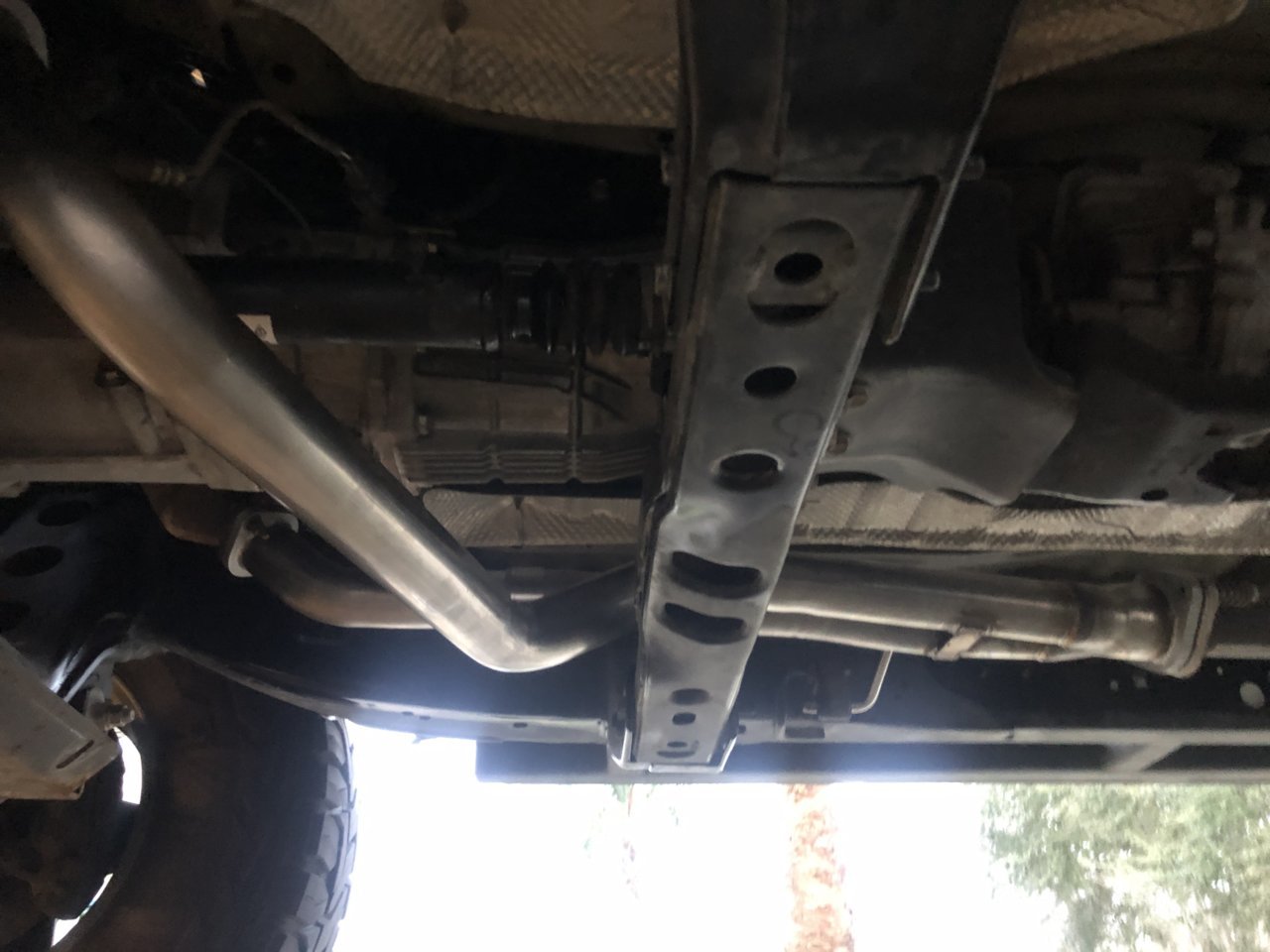

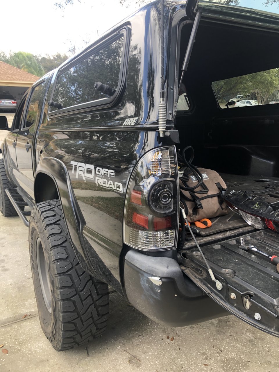

    Installed a URD Y pipe. A little louder than before with a slightly higher note and a touch of rasp above 3500-4K rpms. Had to cut away some of the gusseting on my mobtown skids to make them play nice together.
    Bought some bags from a member on here and got those installed.
    Also installed new black taillights to replace the smashed stock one.

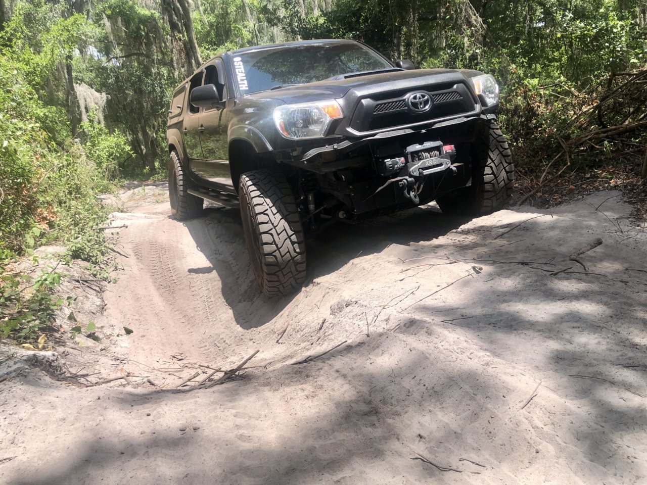

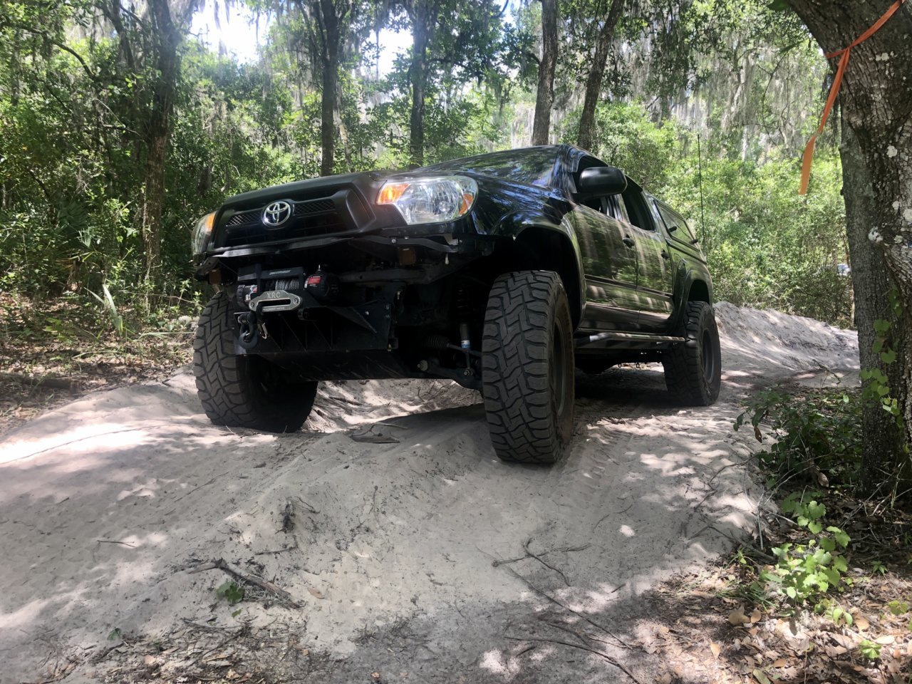

  14. Jun 8, 2021 at 9:20 PM
    #54
    FlyinRyan893
    Oct 28, 2015
    #168016
    768
    Orlando, FL
    Updated the first post with an actual build sheet and added my future plans. @xweslingx is a bad influence...
    Went to a local wheeling event near me at ol Floida Jeep & off-road. Not bad for Florida wheeling.

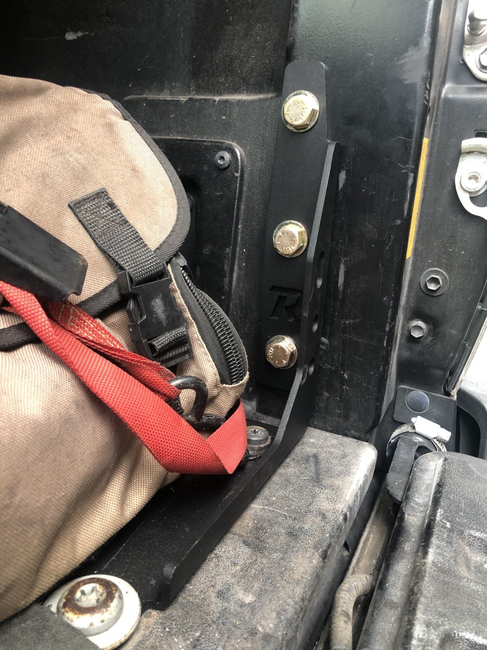

    Also added some Rago bed stiffeners.

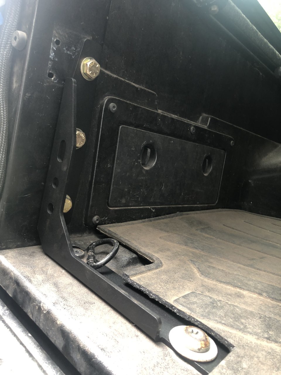

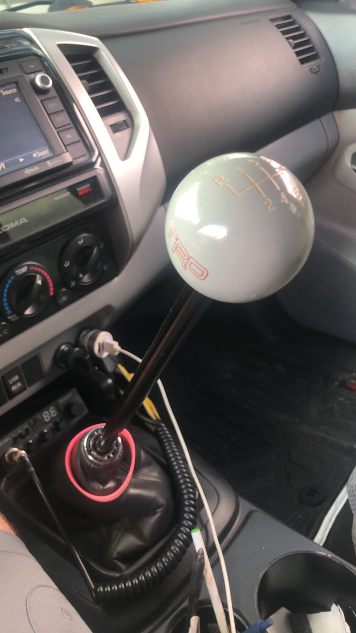

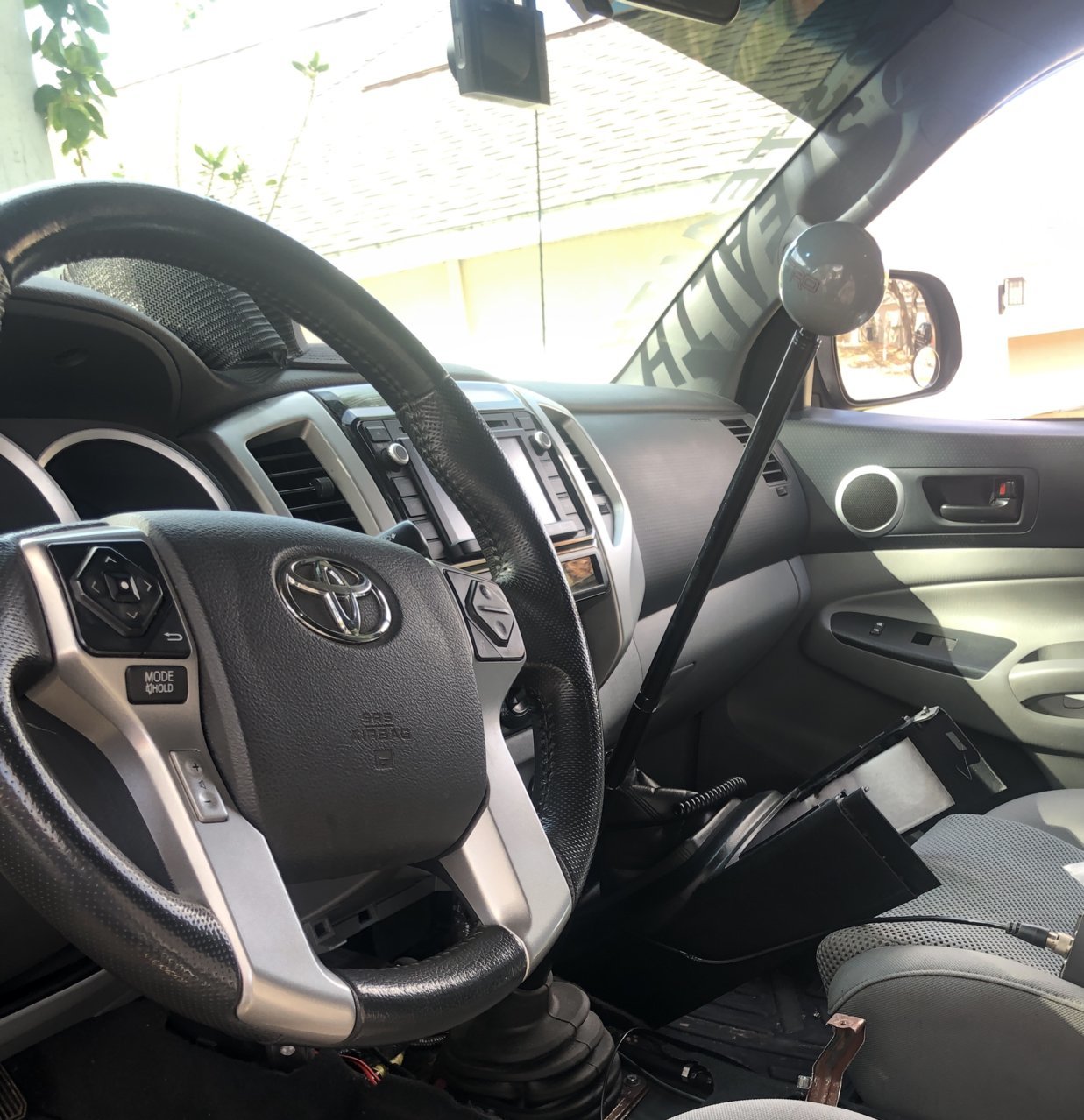

    Added a ridiculous 12" shifter extension

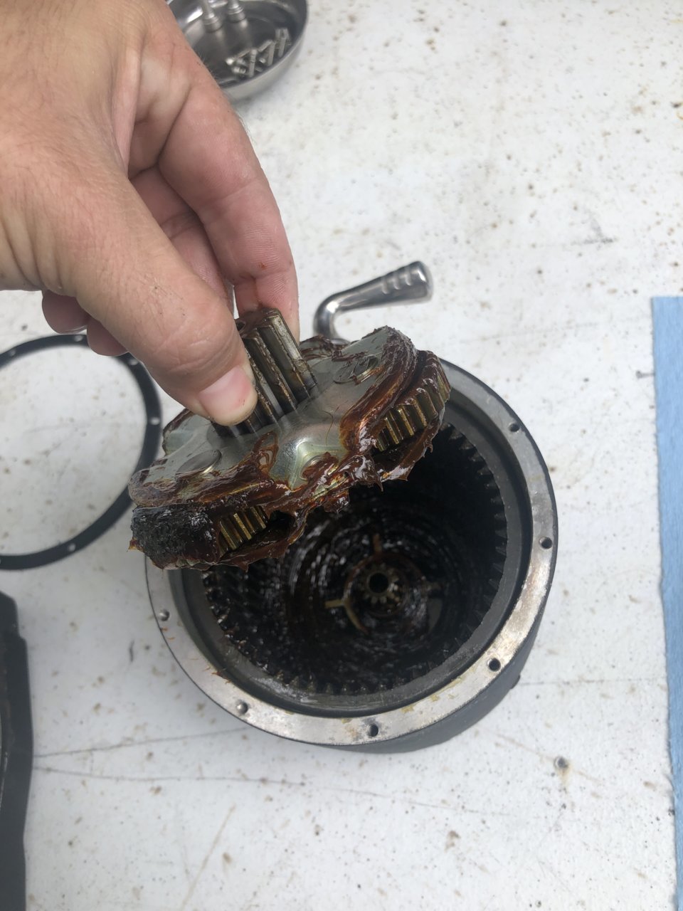

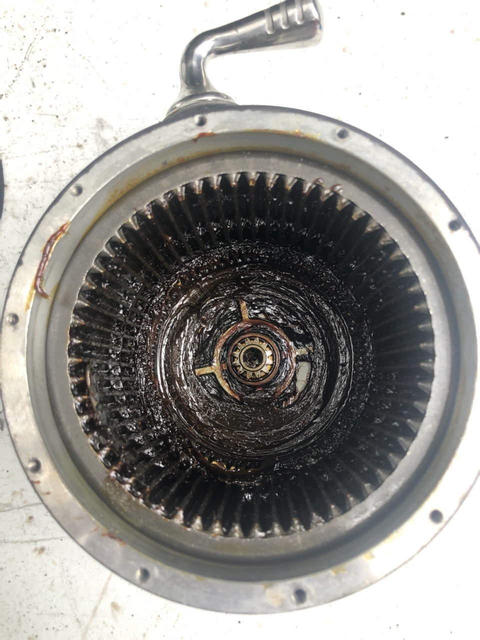

  20. Jun 21, 2021 at 2:42 PM
    #60
    FlyinRyan893
    Oct 28, 2015
    #168016
    768
    Orlando, FL

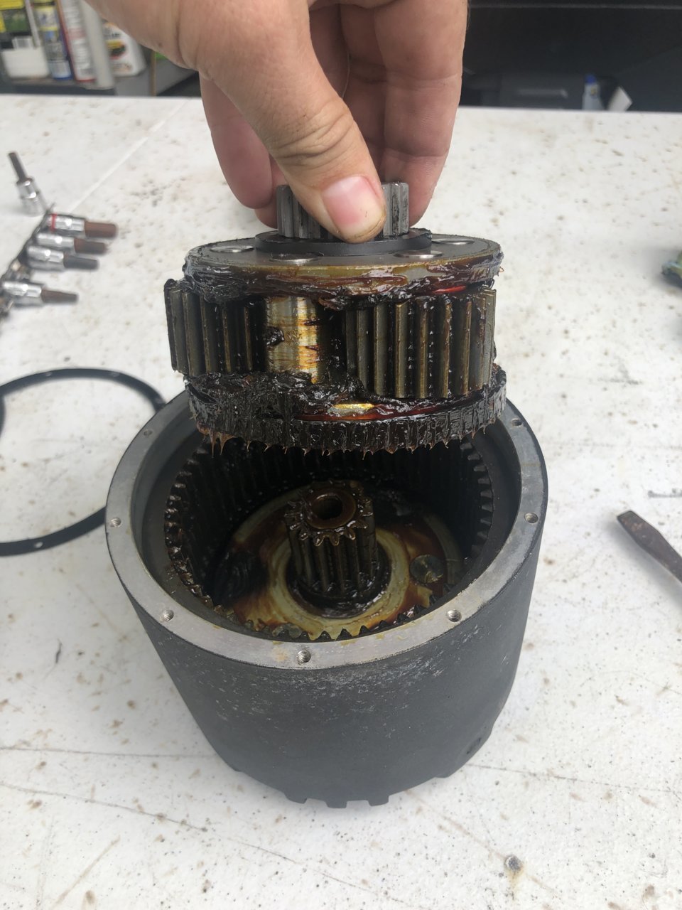

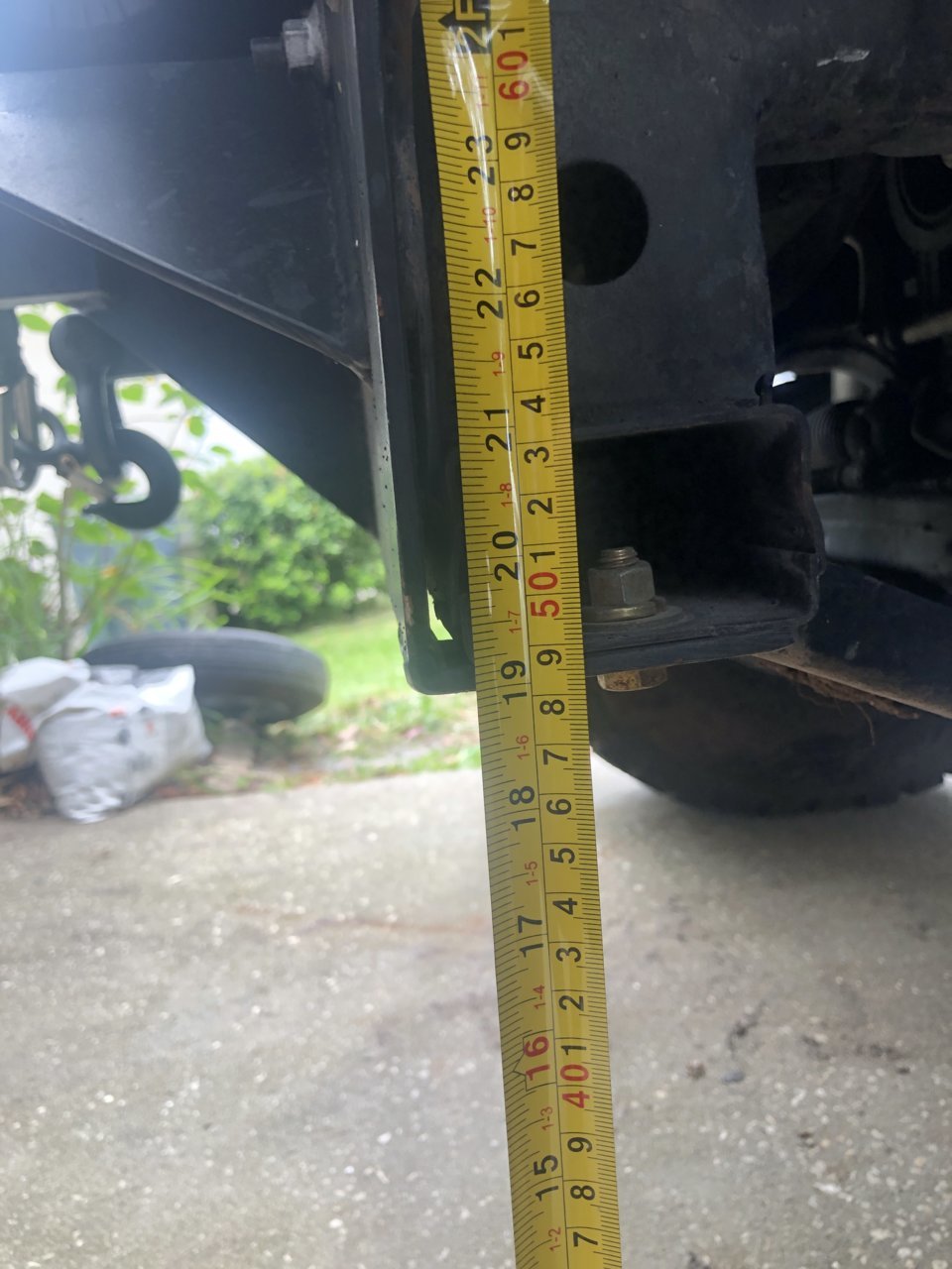

    Tore the winch apart today. Ever since new I could never get this turd to free spool. Couldn’t even get the lever to flip to free spool.
    Upon opening it up I was greeted by this gunk. It was everywhere and it was super sticky, almost a honey or syrup type feel but way thicker. Cleaned all that junk out, which was a pain, and re greased it with some marine grease.
    Tomorrow I’ll probably cut into the front end to raise the crossmember and then modify my winch mount as well. Initial measurements looks like I can gain about 3” of clearance up front. Currently sits at 19” x member to the ground.
