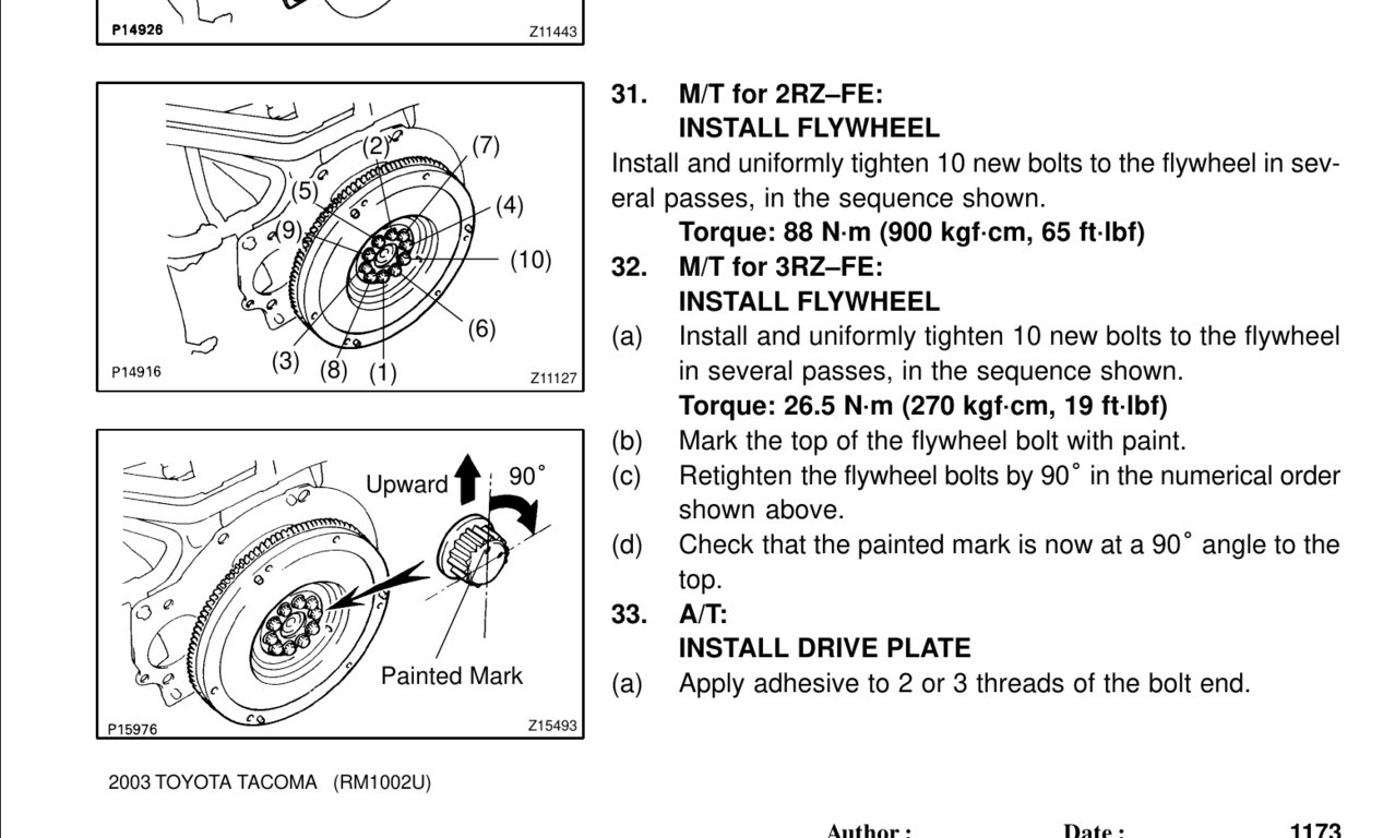

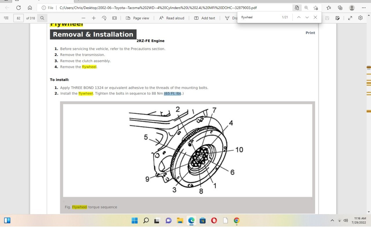

    Thanks OxDEADBEE! I am thinking i need to order this. I am concerned about the torque. here's the screen shot from the manual. That is what I based the 65lbs on.
    Actually, I had them all torqued. i thought it wouldn't hurt to go over them again. Thats when i broke the bolt. Kicking myself in the butt for not just leaving it alone.

    I guess the real question is, what is the right torque spec for my engine?

    Judging by the toyota webpage, the 3rz and the 2rz use different bolts, and the 2rz ones are just straight 65 ft lbs. Very interesting.

    I have always thought mine was the 2RZ. I could be wrong. All the more reason to order from Toyota where they verify with the VIN. I think I need to order by phone, so i can ask for a verification of the torque specs too. The last thing i want is another broken bolt. I got lucky on the last one. There was enough stud to grab with my vice wrench. Or even worse, have it vibrate loose after everything is put back together.

    I tried to call McGeorge. They don't take orders by phone. Placed my order online. Mine is a 2rZ. So 65 ft. lbs. is correct.
