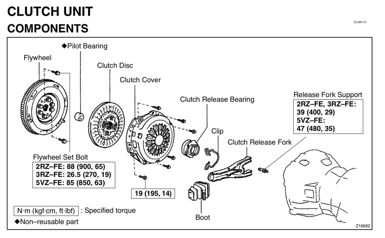

    Is the pilot bushing in the crank?

    I don’t know the answer to that unless the bearing is pressed in from the back of the flywheel… if he’s talking about the pilot bearing

    2003 2.7L has 10 flywheel bolts. If he really only removed eight…
    Or maybe the pilot bearing failed, and / or the input shaft bearing on the transmission, and the pilot “nose” on the crankshaft flared out into the center bore of the flywheel?
    Worse case, if a new pilot bearing still fits the bore, and the transmission input shaft is OK, one could put a new clutch in without refacing or replacing the flywheel, so long as it isn’t terribly burnt and hot-spotted.
