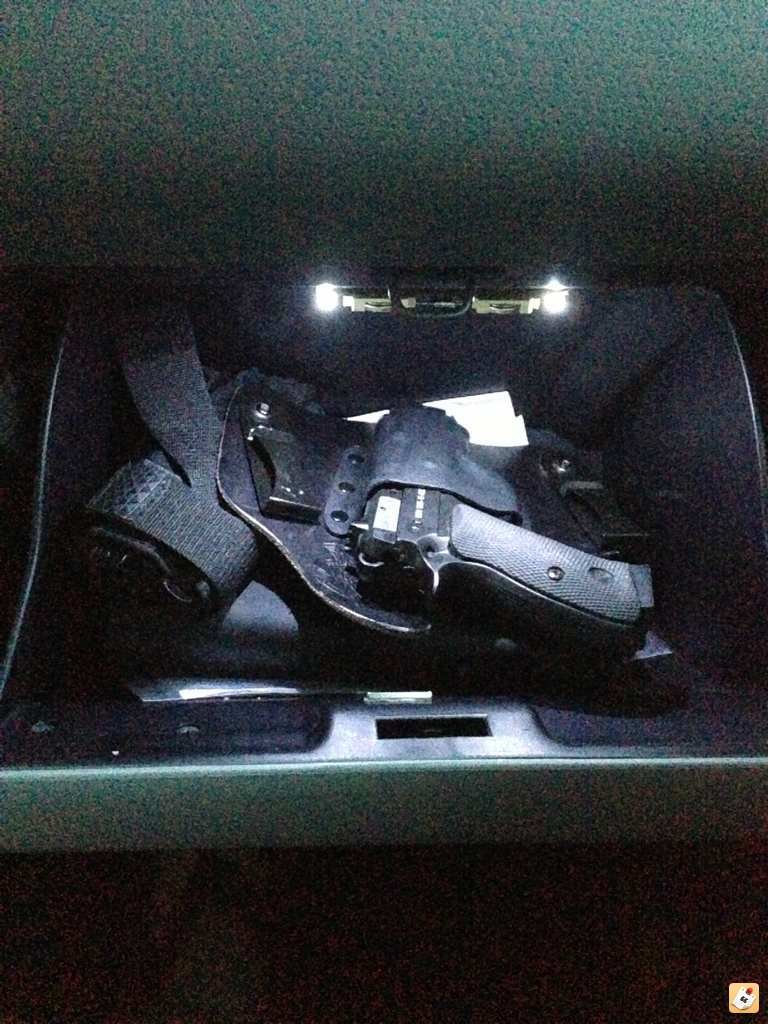

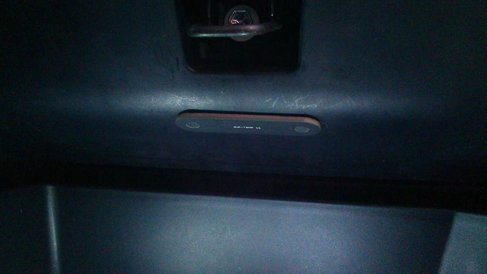

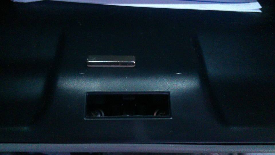

    Above are two examples of the 3VP-RS v1 in the 2012 Tacoma Glove Box... :)
    Mounting Plate Position:
    Actuation Magnet Position:

    Simple. Thanks for pics............

    Simple, yes. However, the exact positioning is somewhat sensitive. I recommend locating both the unit and actuation magnet using either blue painters tape or masking tape while confirming your final positions.

    Got the glove box light in, loving it! Still just enough clearance for the holster to fit to open and close without any issues. It's still light out but it does a nice job of lighting that compartment, thumbs up!
    Oh and I found that offsetting the actuation magnet in front of one of the batteries gives you the best results.

    Absolutely correct - offsetting the magnet to either side of center is the best.
