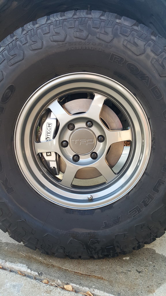

    Hint: if you use Bora wheel spacers, the TRD flat center cap will snap into the wheel spacer when you remove some of the tabs. Then get whatever decal made (or paint) to overlay onto the flat center cap. TRD center cap PTR18-35092 (I think).
    I did this to two sets of wheels. FN Countersteers and SSR wheels.

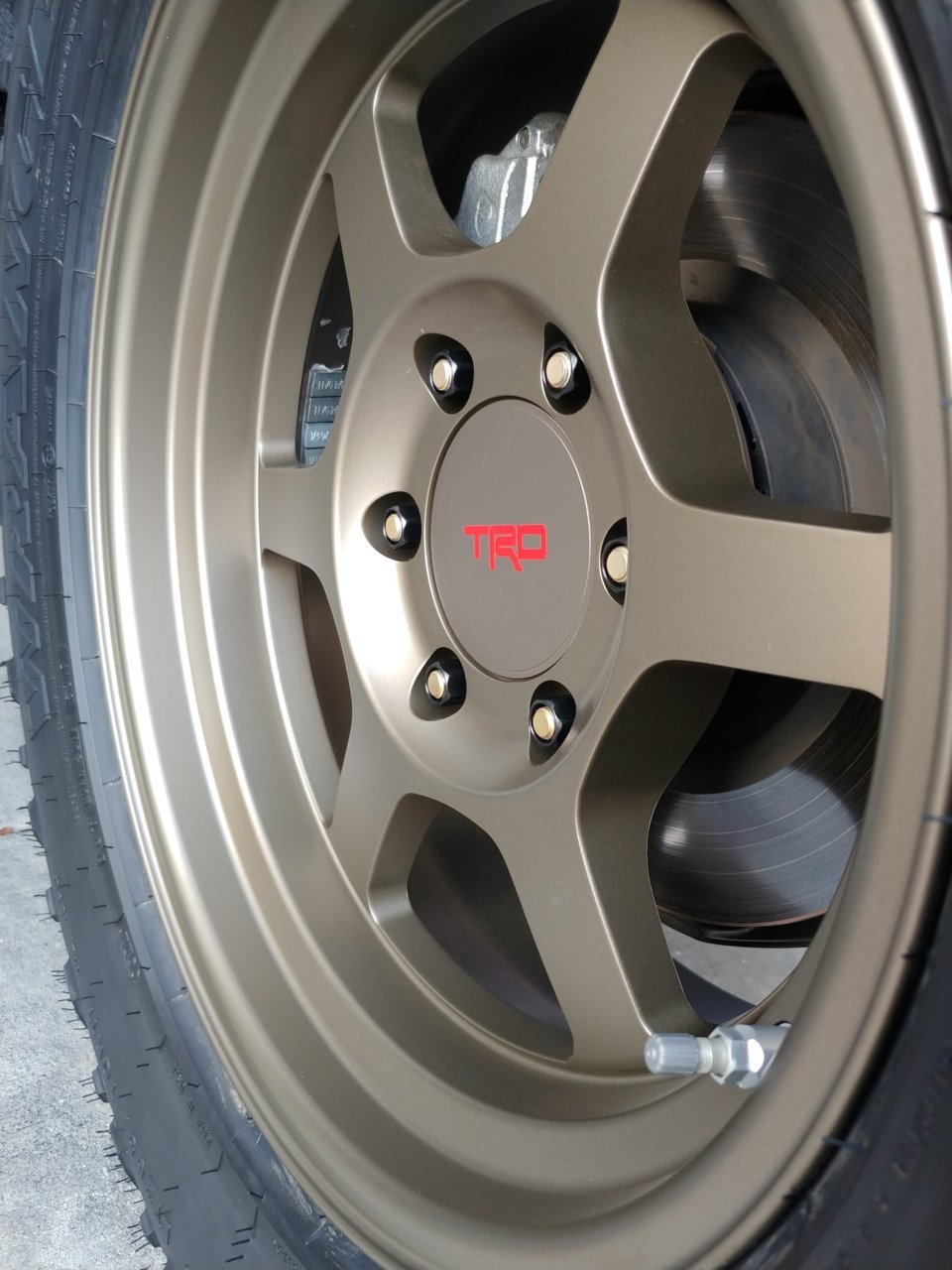

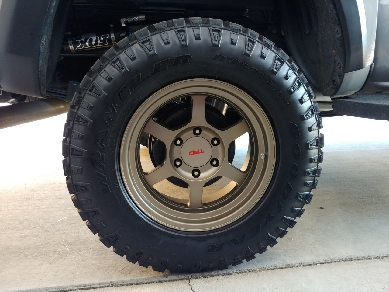

    I'm surprised nobody has mentioned import equipment yet. They sell TRD decals for these wheels. I used the outer ring to center up the decal and removed the ring afterwards 20181011_163002.jpg 20180718_180210.jpg
