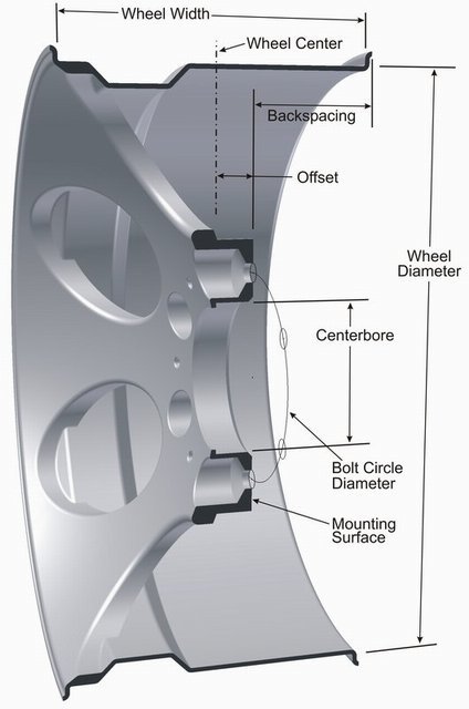

    Can someone help me understand what that really means? I've tried to understand in the past but never really grasped it.

    What exactly aren’t you grasping?
    I’m not being an ass. Just unclear on what information you need clarified.

    +4 offset vs 0, 4.15 backspacing vs 4.5. How does that affect where the wheel will sit or stick out or whatever.

    All of them
    I use this to help myself

    FN one is 1” wider, so it would have been pushed out 0.5” (12.7mm) closer to outside and 0.5” closer to suspension as well if offser was same. However, the Toyota one has +4mm offset and FN has 0. Adjusting for this means that the outer edge of FN is pushed out 16.7mm (~2/3”) farther than the Toyota one and the inner edge is 8.7mm (~1/3”) closer to suspension than the Toyota one.

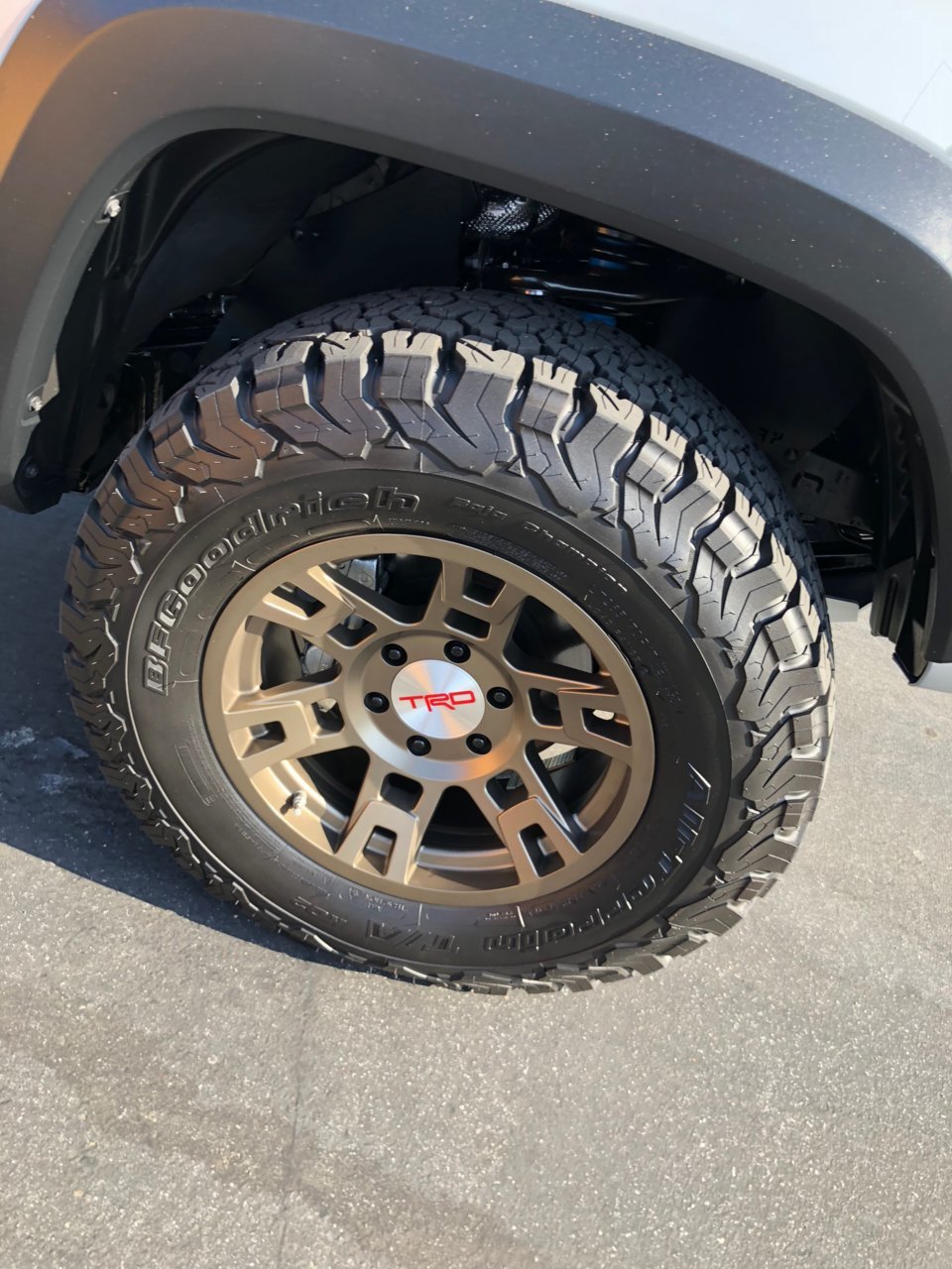

    Got the bronze mounted up with KO2s and added the TRD silver center caps. Very happy with the look.
