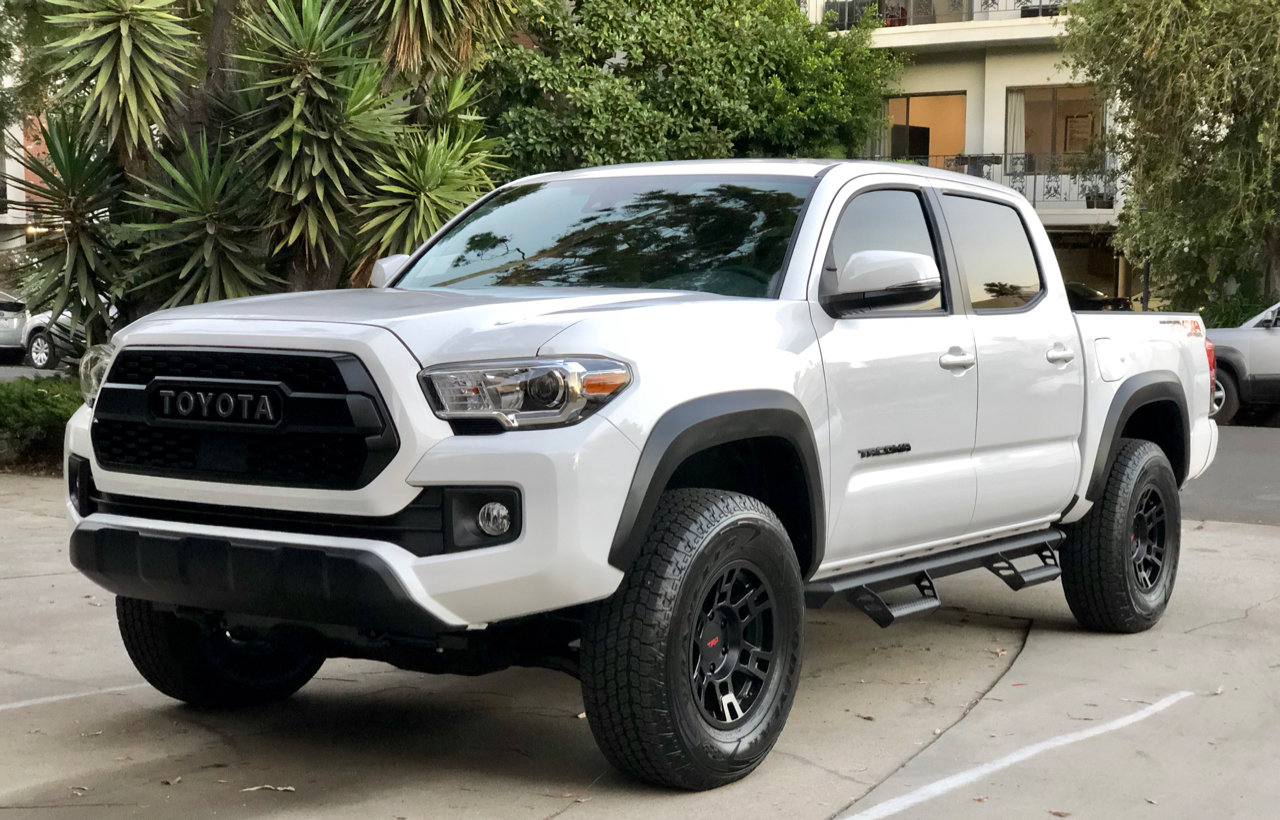

    Truck - 1.jpg I picked up a set of these directly from Dustin a few days ago, and I have only good things to say... great customer service, advice, and communication, and he happily answered all my newbie questions! These are 16's, using the stock tires that came with my Offroad.

    Congrats, You may be the very first person on the site to post a pic of these mounted in a 16!

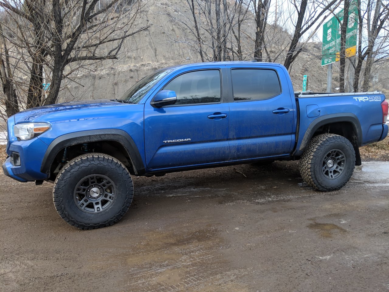

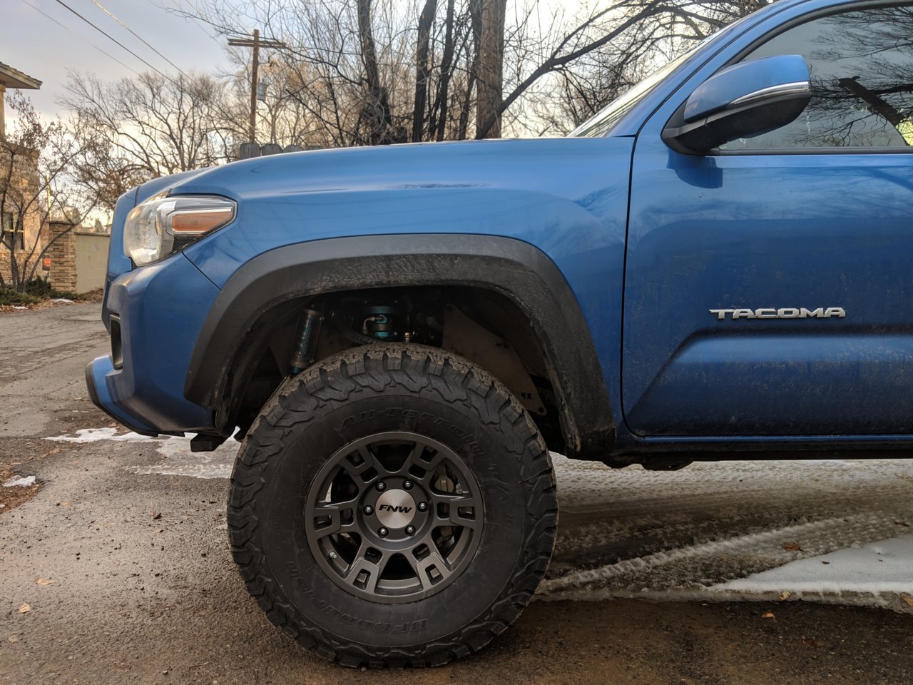

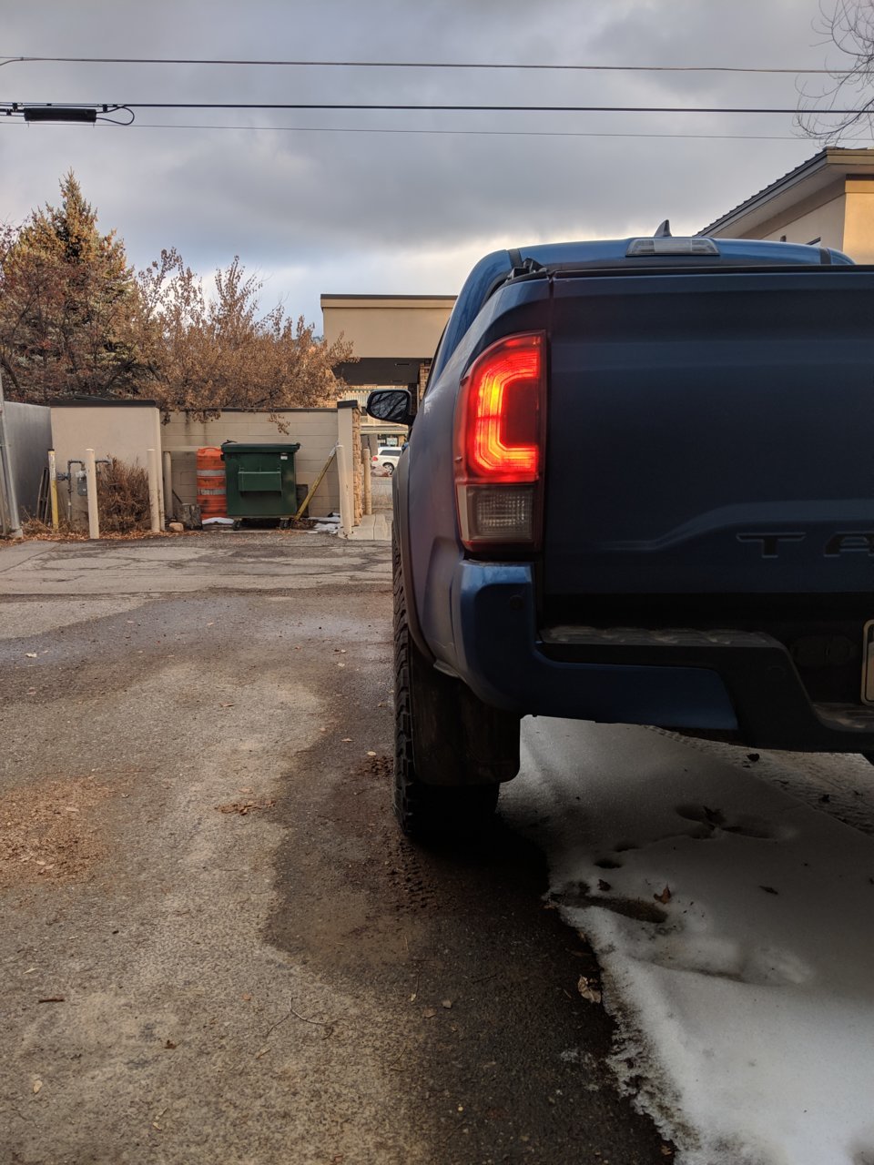

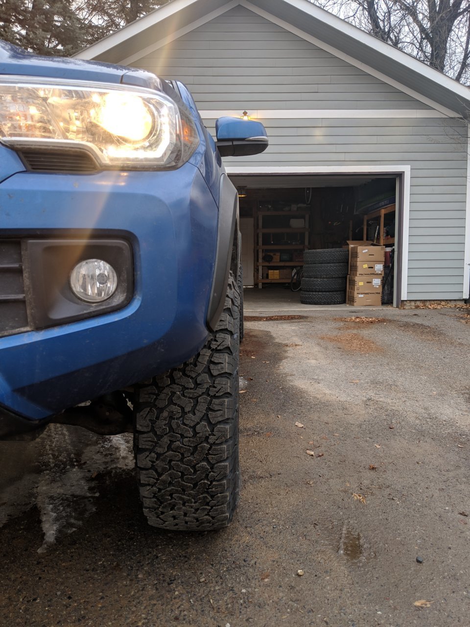

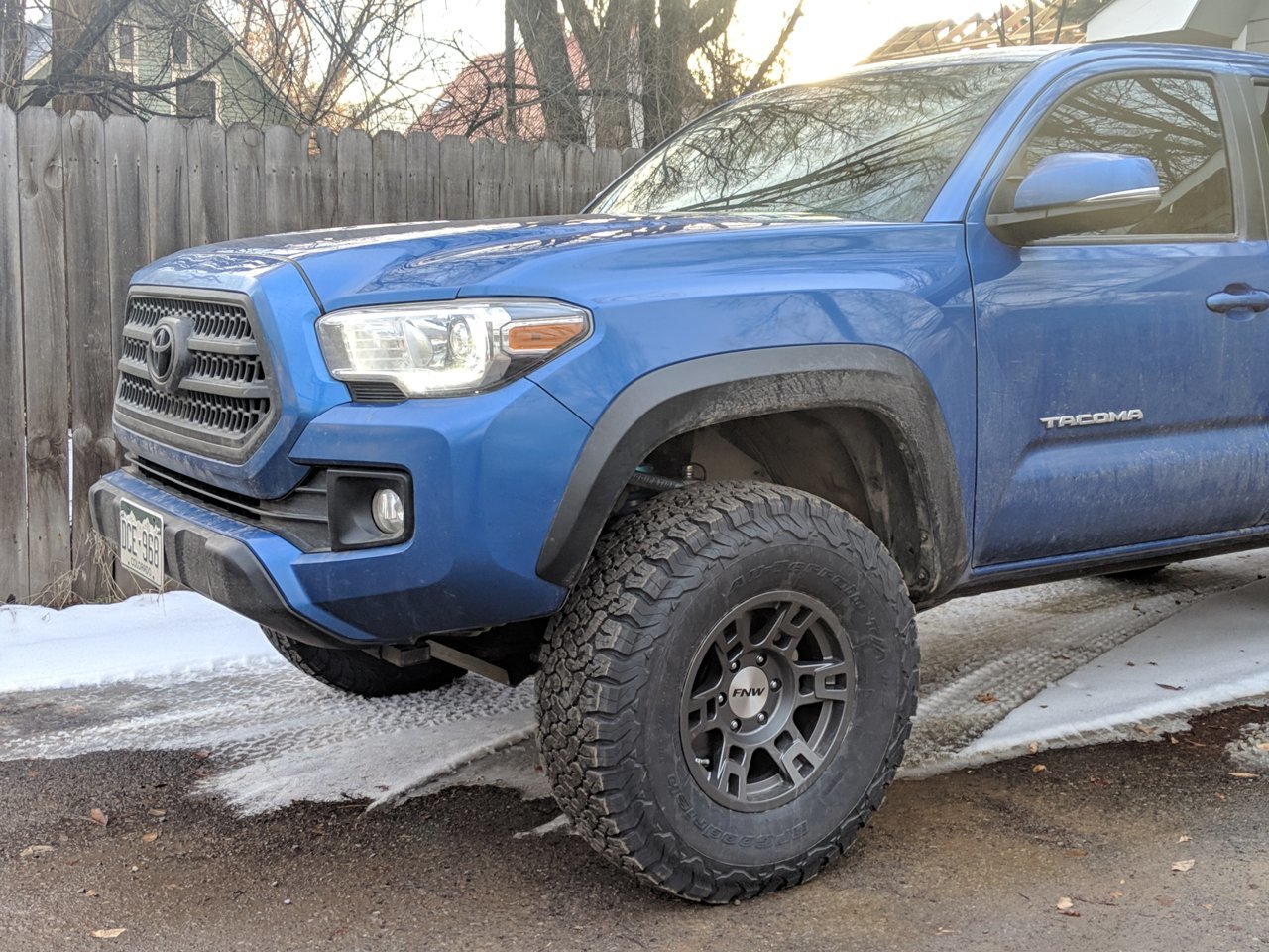

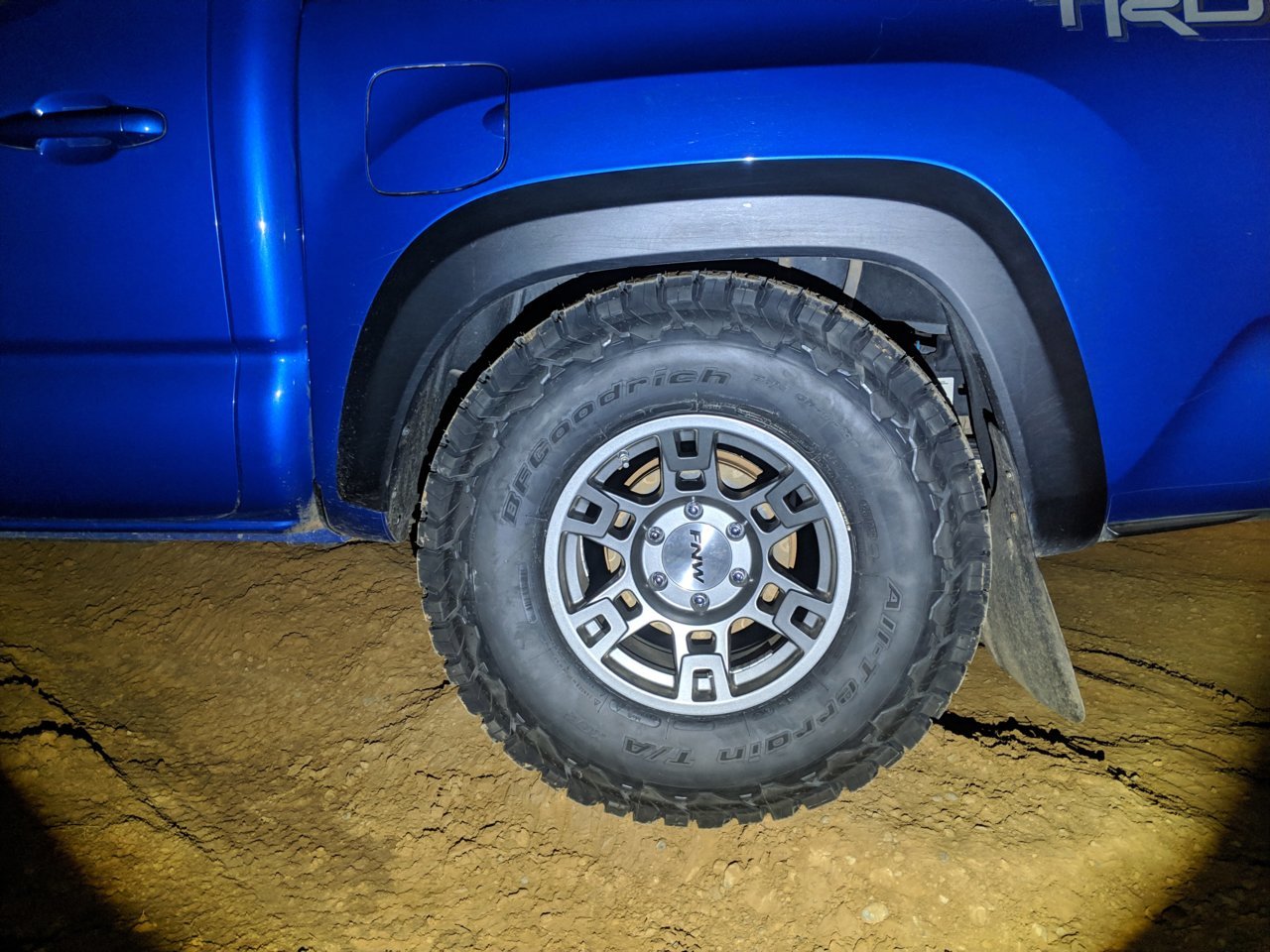

    Got my 16x8 light matte gunmetal Fn Fx Pro wheels on with 285/75/16 tires. They look awesome in every way. I have King OEM suspension with Deaver leafs that add about 2.2 inches in the back and 2.2 inches in front. The rear wheels have no clearance problems, the front I got aligned to +3.0 caster and they don't rub at all in normal driving or full compression, but do just a little when turned hard and fully compressed on the cab mount.
    00000IMG_00000_BURST20181208162045263_COVER.jpg IMG_20181208_161258.jpg IMG_20181208_161952.jpg IMG_20181208_162139.jpg IMG_20181208_162116.jpg IMG_20181129_202706.jpg

    Are you running stock UCA's?

    No, total chaos

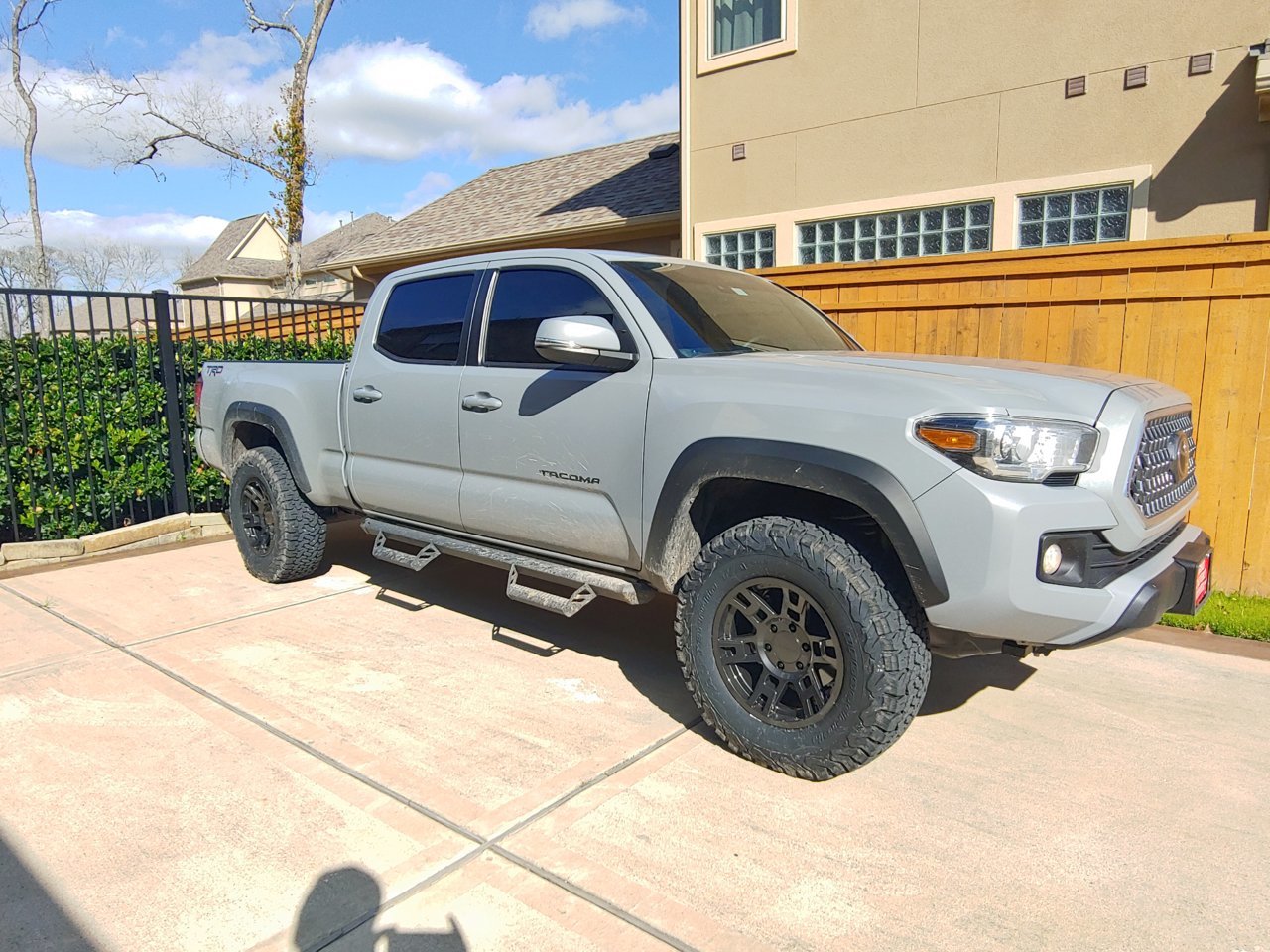

    2019 Tacoma Offroad
    2019 Cement Gray TRD Off Road
    Dark High Gloss Gunmetal
    275/70/17 BF Goodrich KO2
    They slightly rub on full turn going up a steep embankment other than that they ride well

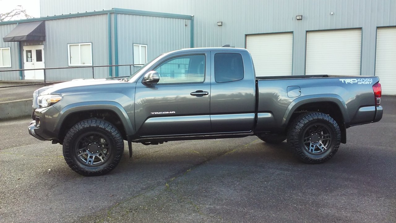

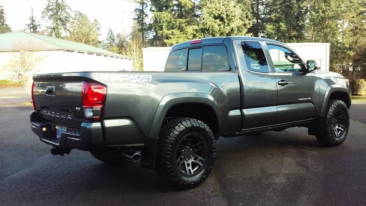

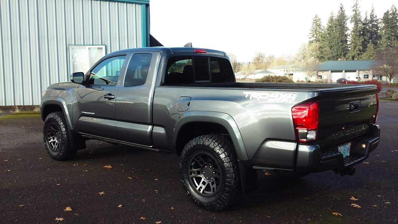

    Here are my 17x8 FX PRO wheels in gmg with zero offset, The tires are 265 70 17 Nitto Ridge Graplers with stock suspension
