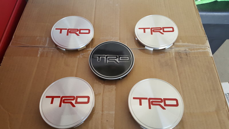

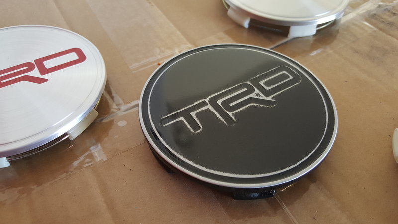

    I used aircraft stripper and removed the clear coat and the red trd from the stock toyota flat caps. Then i painted the whole cap flat black. Once that dried i used a scotch bright pad and sanded down the cap which removed the paint from the edges of the letters and the rings around the outside edge. I then clear coated the cap and it matches pretty good to the dark gloss gunmetal wheels.

    Good job! That's a lot of work.. I'm just looking for a sticker lol
