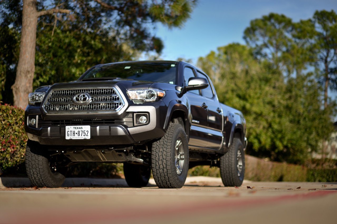

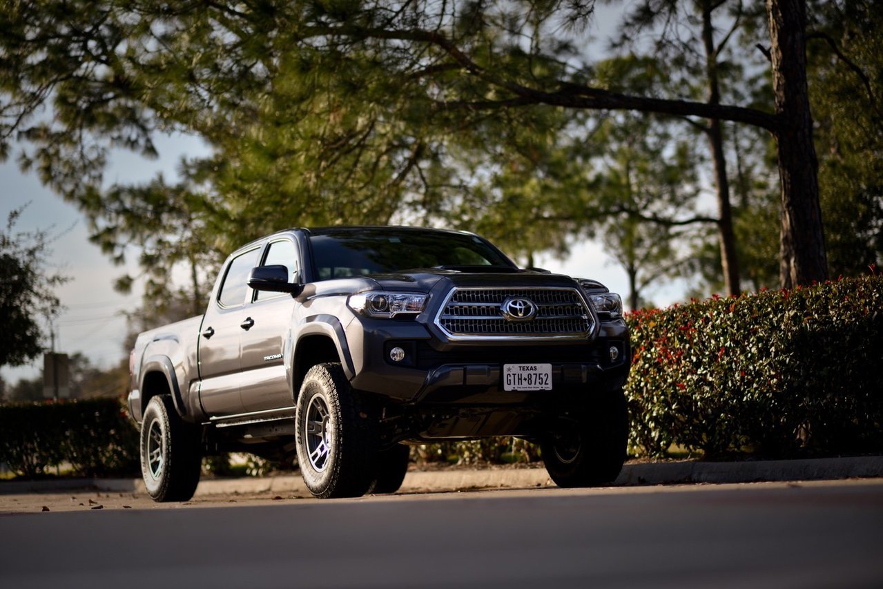

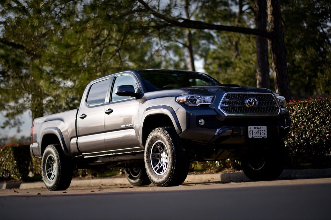

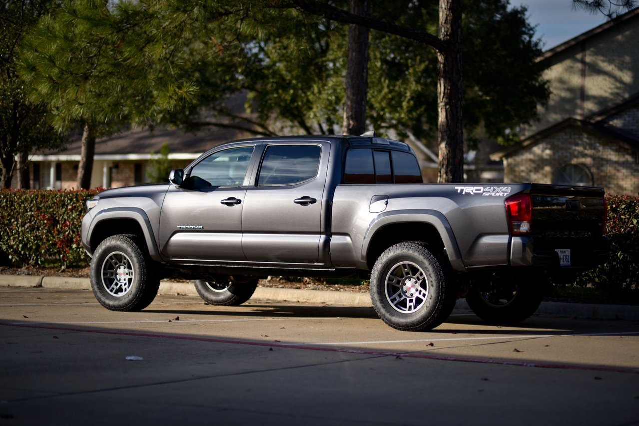

    Got my FN FX Pro wheels in matte gray mounted up last week. Very happy with the quality and customer service
    I've posted this elsewhere on TW, but here it is again.
    Fox coilovers - spun up 1/2"
    Toytec 3/4" strut spacer
    Icon AAL
    Stock UCA
    Toyo AT 285/70/17
    I initially installed the coils as they came and without the spacer. This yielded only about 1" lift in the front and the 285's rubbed at mid lock. With the 3/4" spacer and additional 1/2" on the coils I got another 1-1/2" which leveled the front with the rear and no more rubbing.

    Clayh wow man your truck looks tits!!! Very well put together..:cheers:

    So to clear 284-70-17, your total lift is 1.5"all around wih 3/4" wheel spacers?

    Thanks guys.
    No.
    The fox coilovers only lifted it 1" in the front. Then I added the Toytec 3/4" strut spacer and raised the coil 1/2" to get about an additional 1 1/2". Total lift in front is about 2-1/2".
    No wheel spacers.
    This is the spacer i'm referring to - http://toyteclifts.3dcartstores.com/Front-Top-Plate-Spacer-Kit_p_333.html
