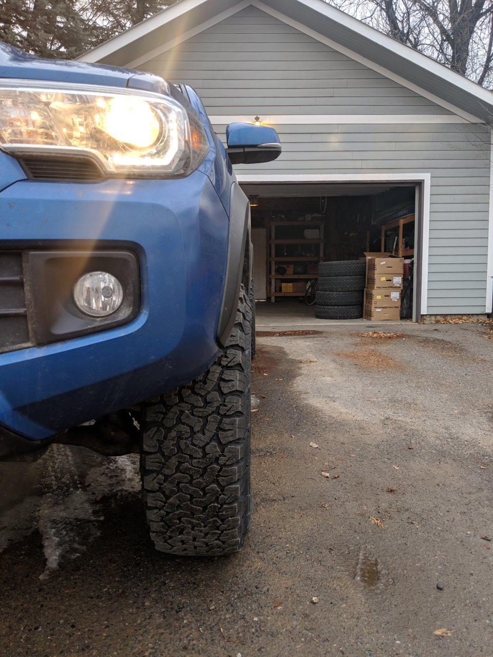

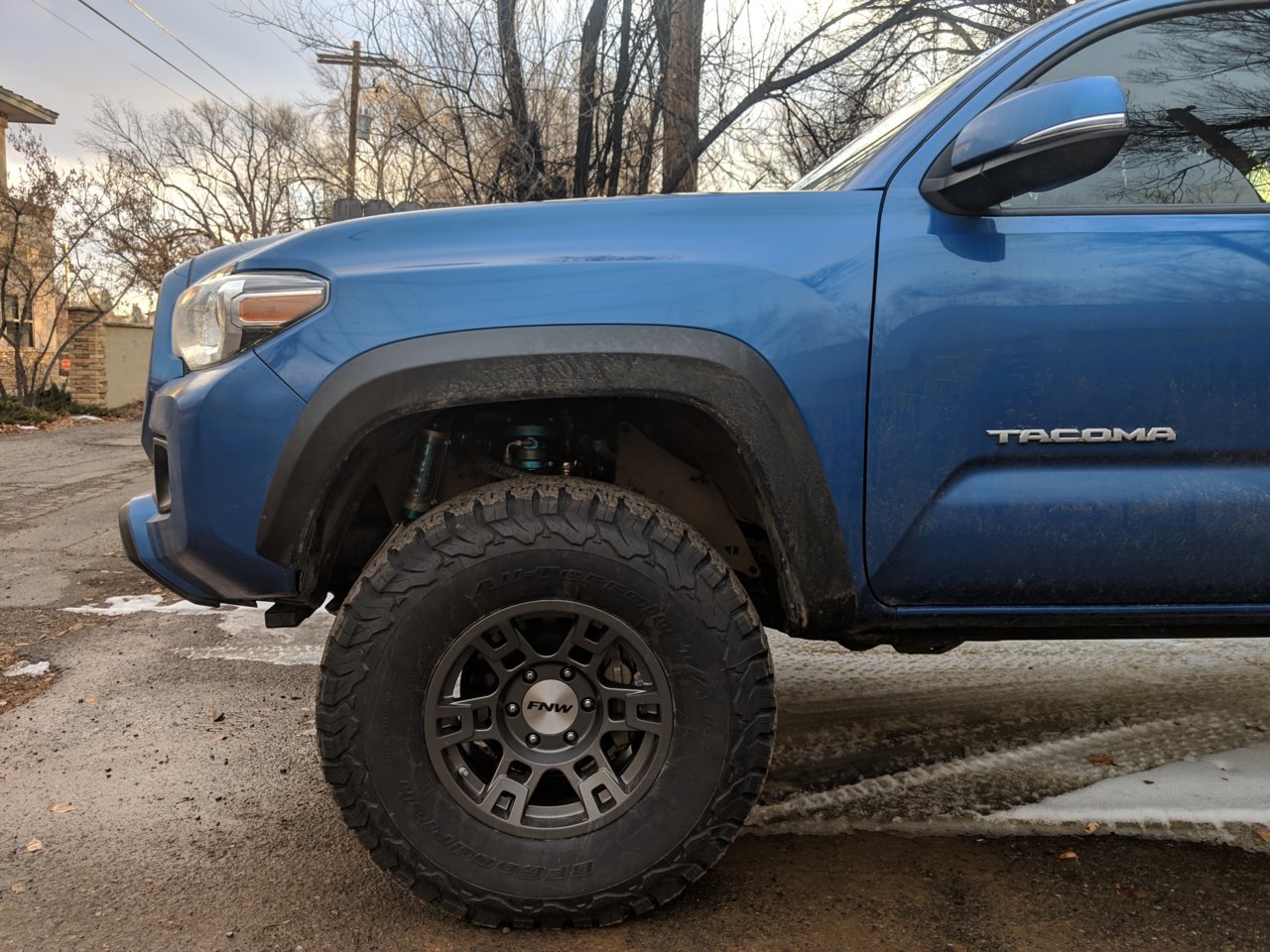

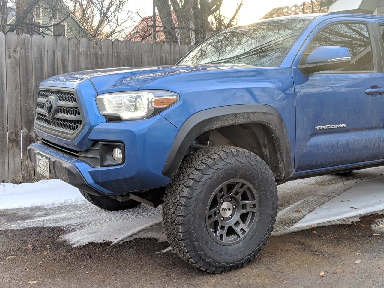

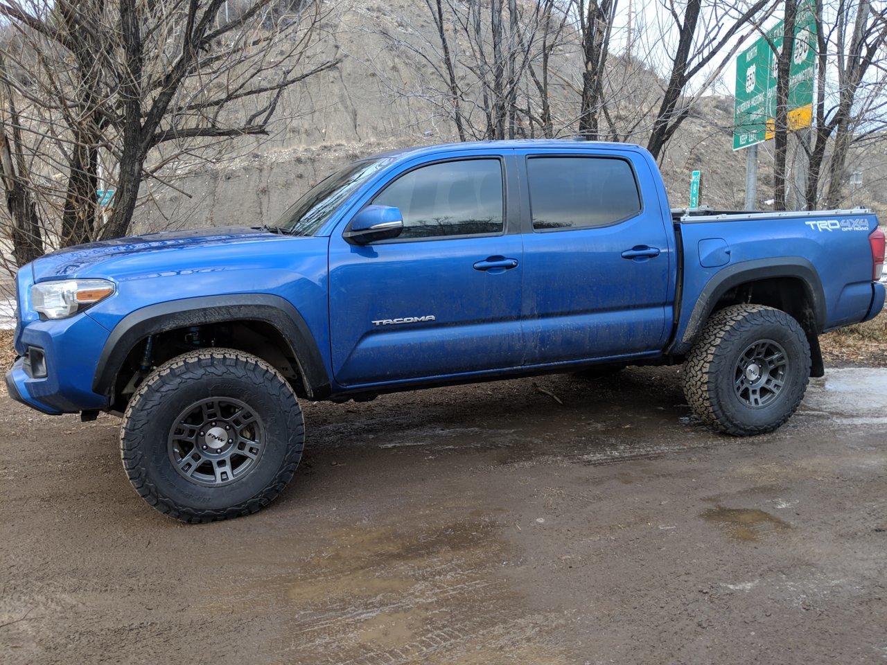

    Got my 16x8 light matte gunmetal Fn Fx Pro wheels on with 285/75/16 tires. They look awesome in every way. I have King OEM suspension with Deaver leafs that add about 2.2 inches in the back and 2.2 inches in front. The rear wheels have no clearance problems, the front I got aligned to +3.0 caster and they don't rub at all in normal driving or full compression, but do just a little when turned hard and fully compressed on the cab mount.

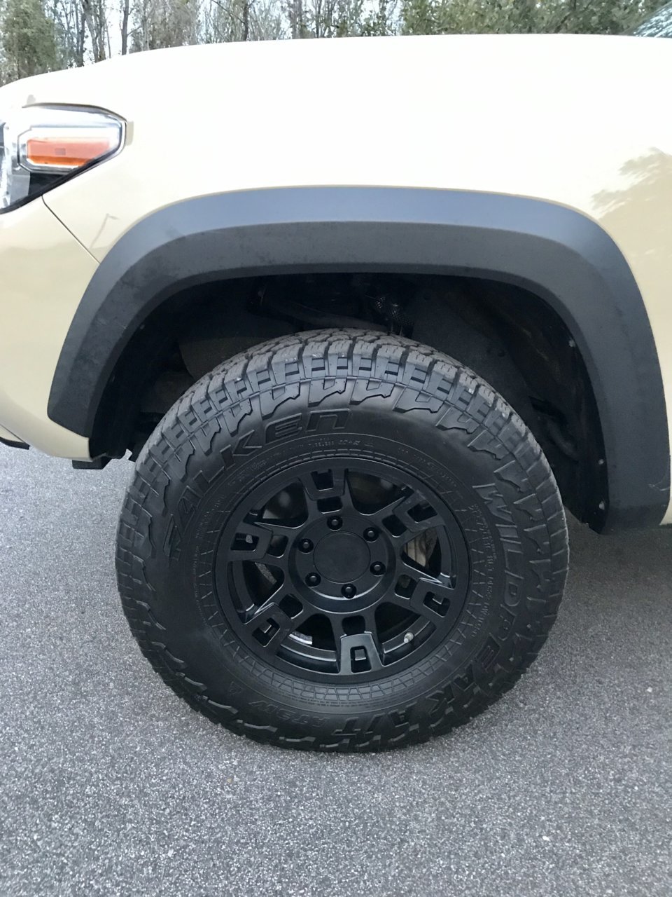

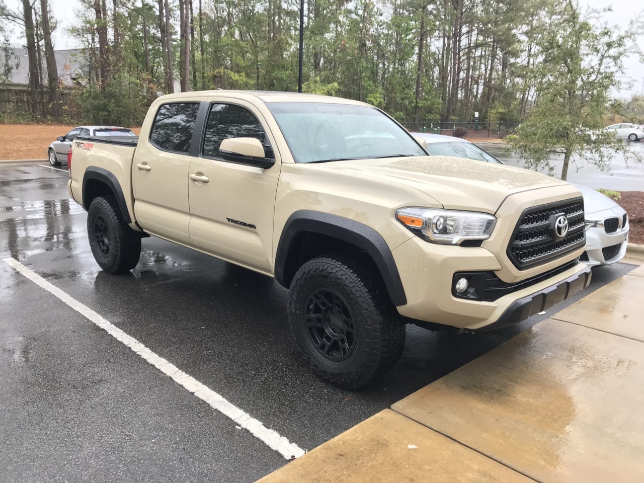

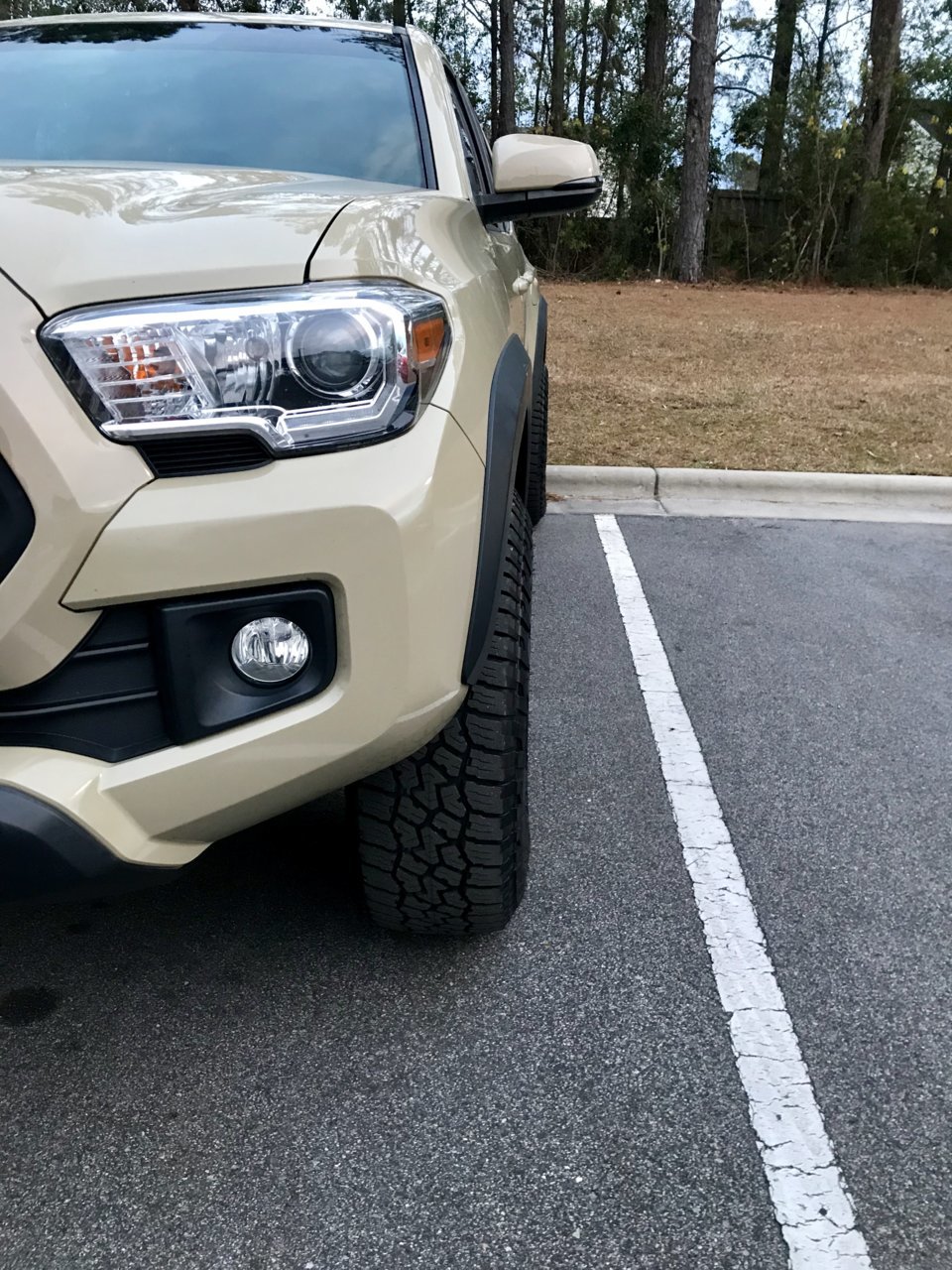

    Finally got my new matte black 16x8s installed. Perfect fit with the 265/75r16 Wildpeaks.
    B82B1D7F-55F7-4C0E-B20E-AE59CD0B27A1.jpg E7CE4AA0-2476-45D9-B844-0062AC885770.jpg 6835619A-C536-4E13-B217-B21F0921B8E1.jpg
