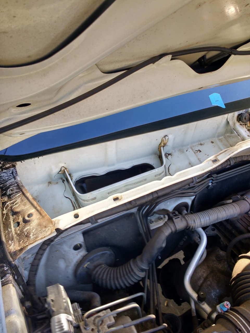

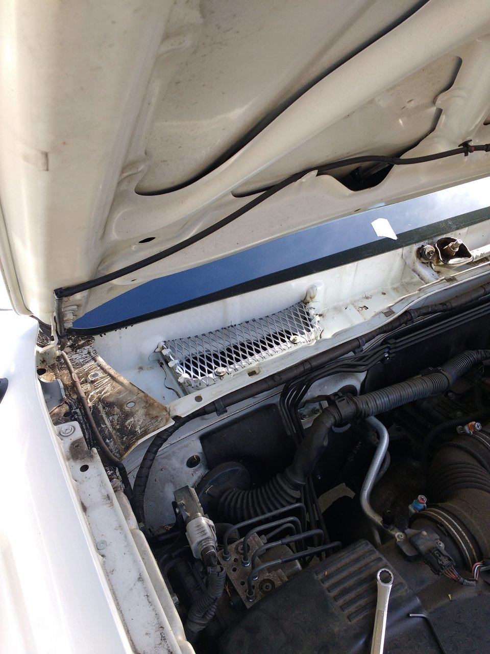

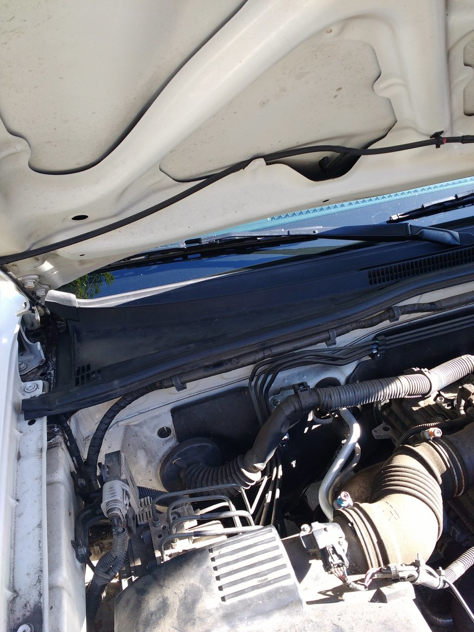

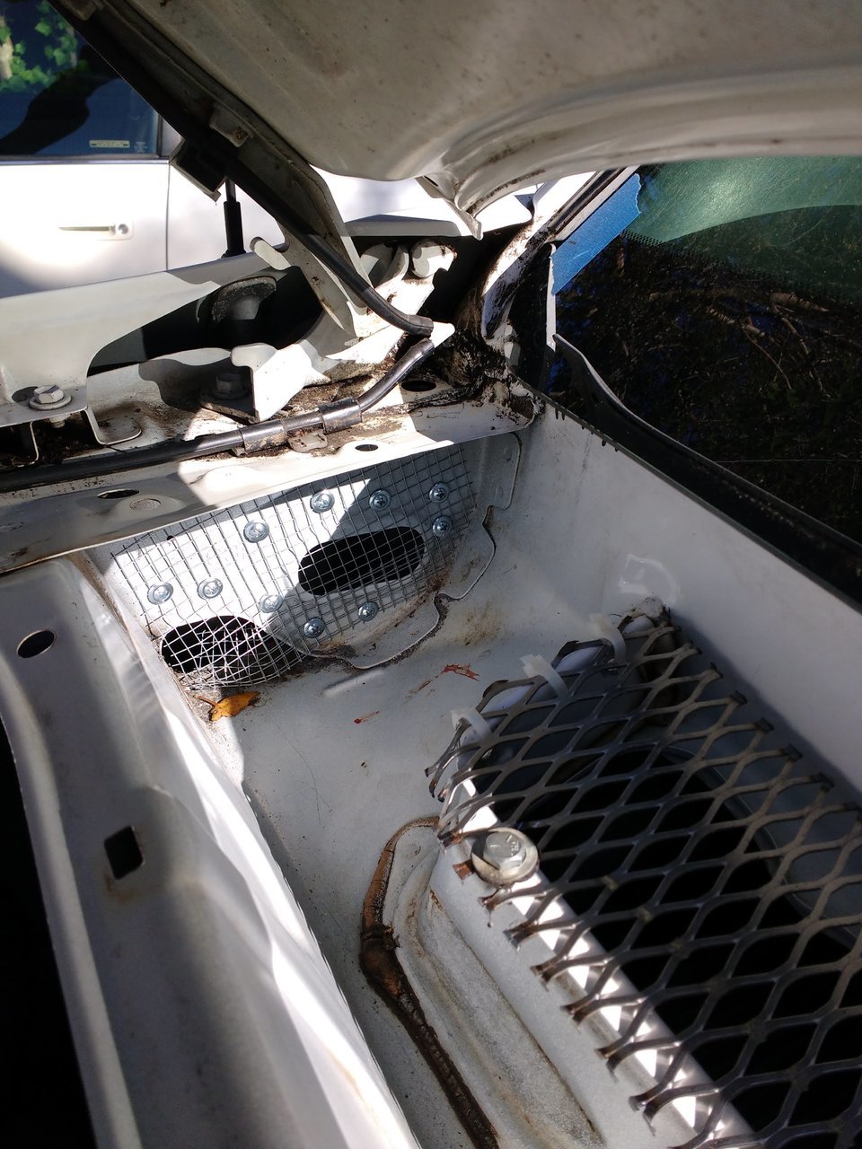

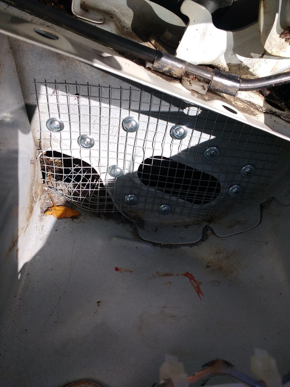

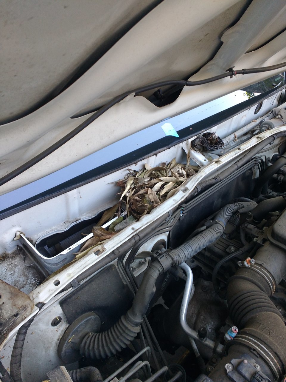

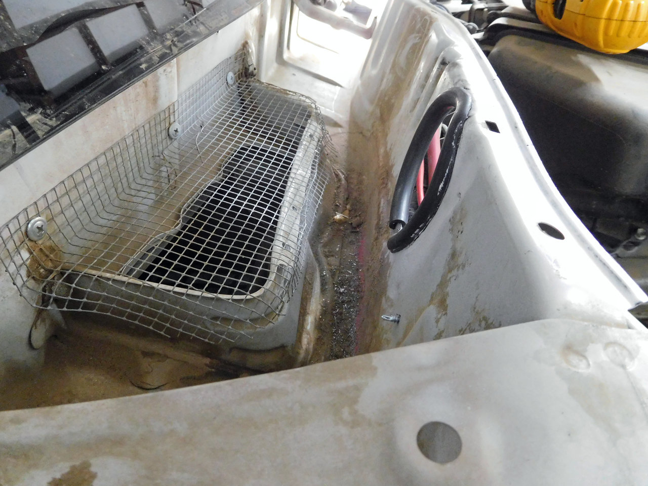

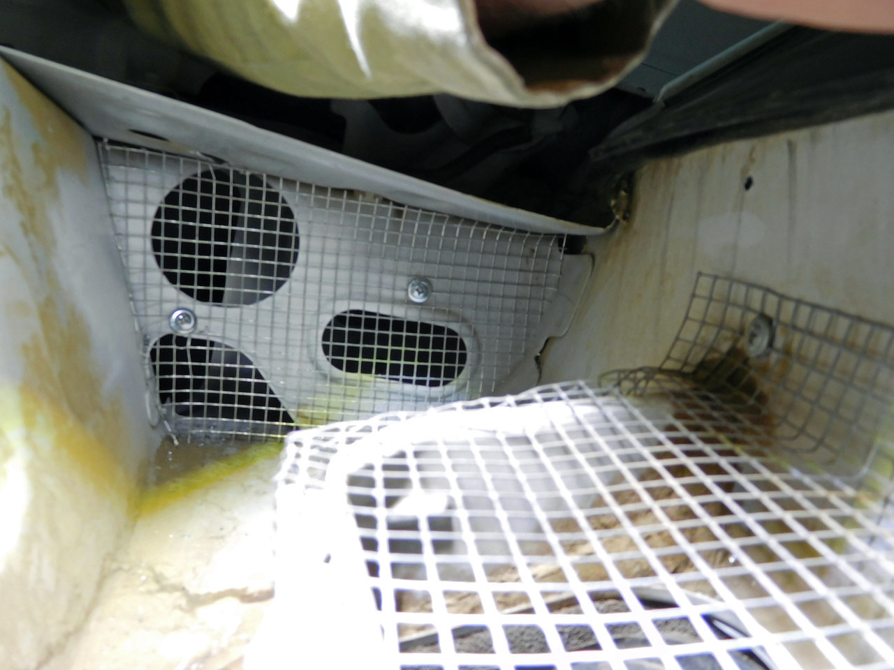

    I also found a rat's nest in my 2008 Tacoma. It was under the black plastic cowl, passenger side, right next to the fresh air intake, which leads directly to the cabin air filter. The cabin air filter was soaked with rat piss and smelled horrible. I tried to fix it, following the example of some other member's pictures here on tacomaworld. My repair job is kind of a hack, but I think it should work.
    First I took off the wiper arms and the black plastic cowling. Then installed a grate over the fresh air intake. Used two bolts, and some zip ties in a few spots, which probably isn't ideal, but I think it will be ok. I also put some wire cloth to the far left and far right sides of the cowl, because I think that's where the rodents are coming in from. The wire cloth might cause a problem in time, since leafs and debris will probably start to get collected there. That could eventually prevent proper water drainage. But, I can always remove the cowl again once a year and just clean it out with a shop vac.
    I haven't had a chance yet to remove the front fenders, but I imagine that under the fenders and the side-cowl area there is probably more leaves and debris packed in there by the rodents. Anyway, here are my pictures up this point... hope this helps someone else out.
    1. Black plastic cowl at passenger side.jpg 2. Rat nest near fresh air intake.jpg 3. Rat nest cleaned out.jpg 4. Metal grate installed.jpg 5. Metal grate installed.jpg 6. Wire cloth on side cowl drain.jpg 7. Wire cloth on side cowl drain.jpg

    Better use something with smaller holes. A mouse can squeeze through 1/2" hardware cloth.
