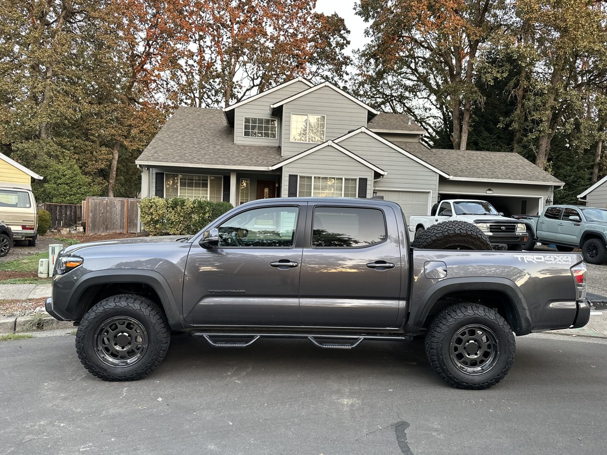

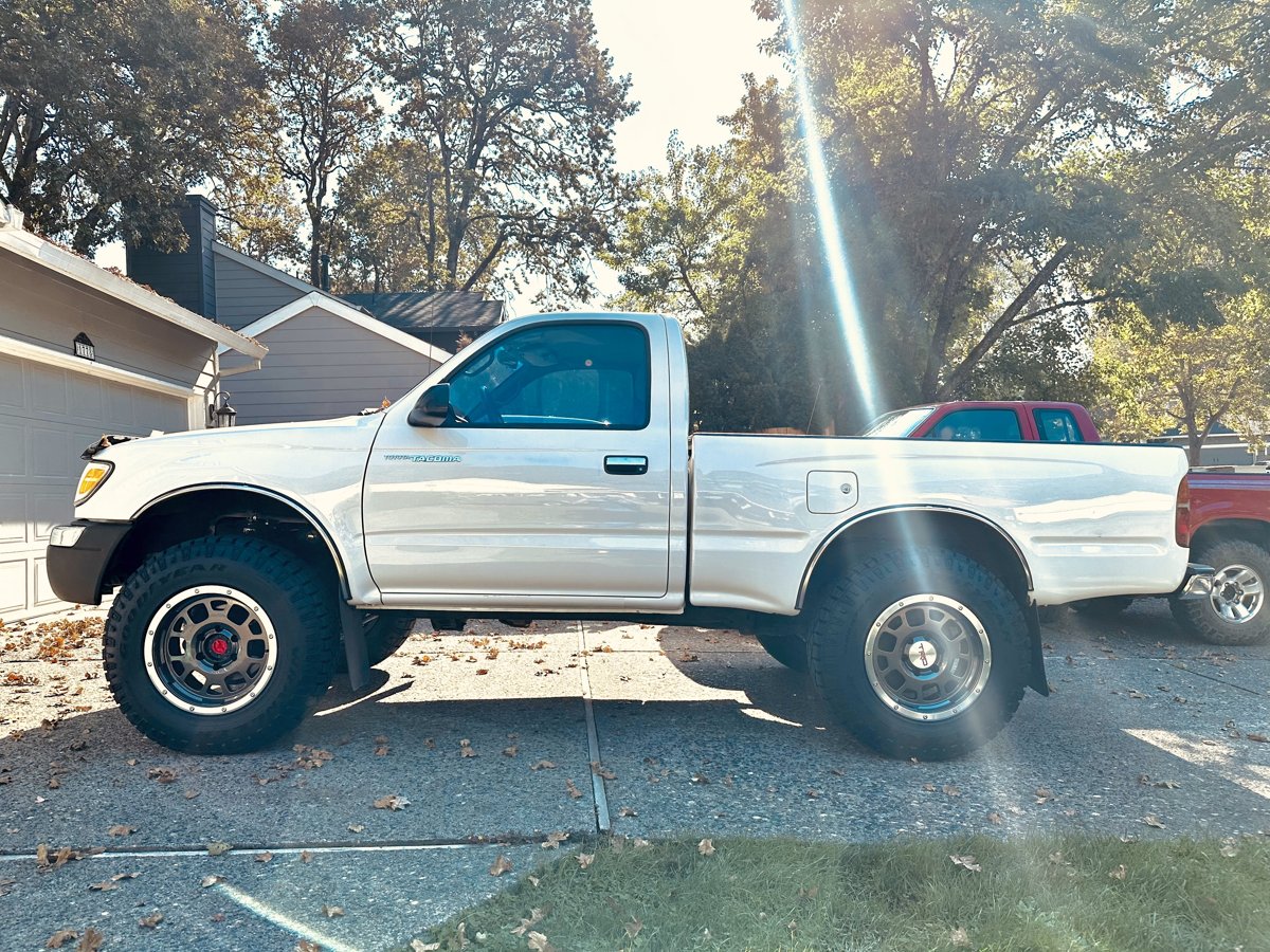

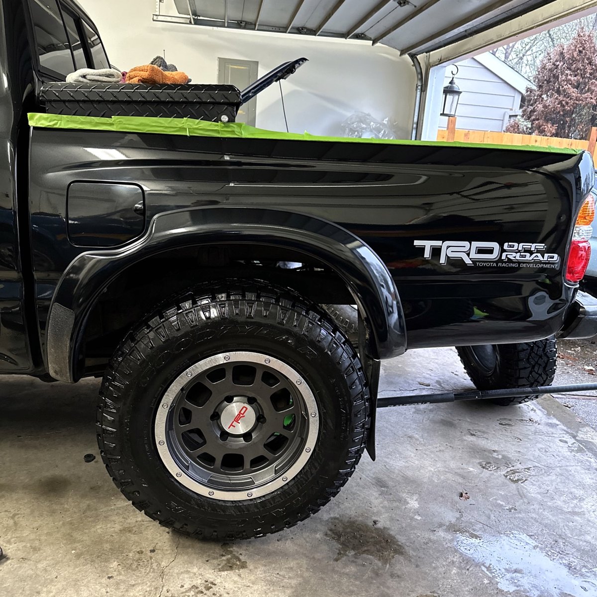

    One of our awesome customers has quite a collection of Tacomas, and he picked up multiple sets of Overlanders (note that the wheels aren't bolted onto the vehicles yet in some of the pictures he sent us, as he was still getting an idea of which wheels he wanted on each truck).
    [​IMG] [​IMG]

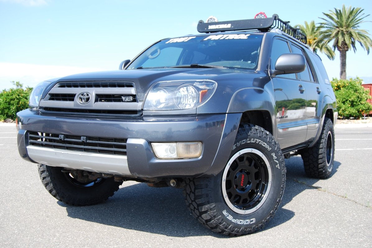

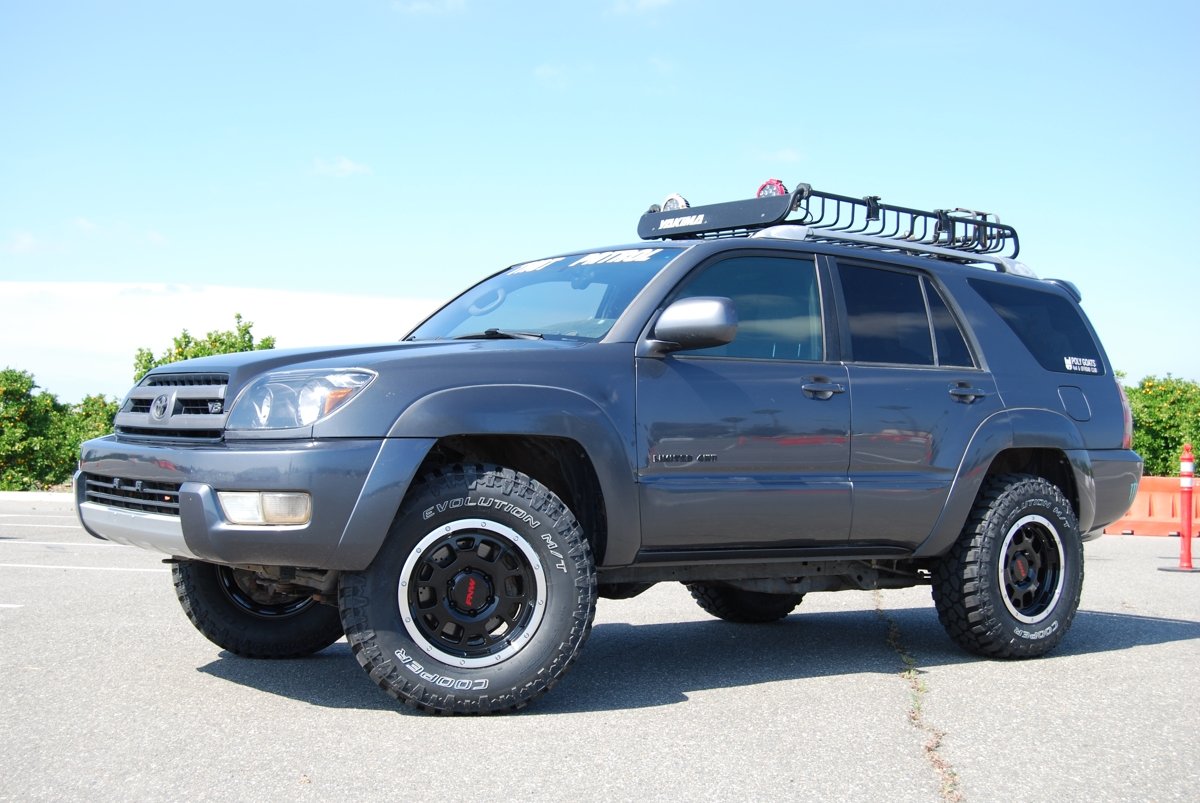

    Trying to determine if this offset will work with my 4th gen 4runner. 3" lift with aftermarket UCAs. Currently with the 5th gen trail wheels with 285/70/17 until I decide what I'm going with.

    Hi @6MTPro
    I'm sorry I didn't reply sooner.
    Your 5th Gen Trail Edition wheels are 17x7.5" +15mm offset and 4.84" backspacing. The 17x8.5" -6mm offset Overlanders will fit well on your 4th Gen 4Runner with 3" lift , aftermarket UCAs and 285/70R17's. The backspacing is 4.5", so you'll have plenty of UCA clearance.
    The Overlanders will sit approximately 1.5" wider (per corner) compared to your 5th Gen Trail Edition wheels. The stance will be more aggressive, but not over the top to the point that the wheels are hanging out way past the body.
    You'll have to do some modifications to plastics inside the front wheel wells to eliminate rubbing, but with aftermarket UCAs and 285/70R17's you should be able to avoid a body mount chop (unless the tires are super aggressive and/or your UCAs don't allow for enough positive caster).
    Here's an example of a similar setup from one of our customers:
    Jonah's 4Runner with Gloss Black Overlander (1) 1200.jpg Jonah's 4Runner with Gloss Black Overlander (2) 1200.jpg

    This is exactly what I was looking for when trying to decide what route to go with my 2004 V8 4Runner. Have the 3" lift and the aftermarket UCAs with 285/70/17 and 5th gen TE wheels while keeping aftermarket rokblokz mud flaps. What would be a better fit the overlanders with the 8.5 -6mm offset or the Konig Countersteer at 8" -10mm offset?
