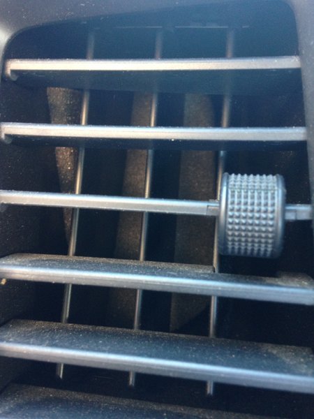

    Since it's so hot out right now I've been running the ac a lot, the other day i had it on full blast and a piece of foam broke loose and now it's blocking the vent to the left of the radio when the ac is on. Where did this foam come from? And how can I get it out of the vent? Is it hard to get access to the inside of the vent? If it's gonna be a really long process I'm really considering taking it to the dealership and paying the hour of labor for them to do it.

    That's too much... That should be a manufacturer warranty issue.
    Toyotas quality standards are higher than that.
