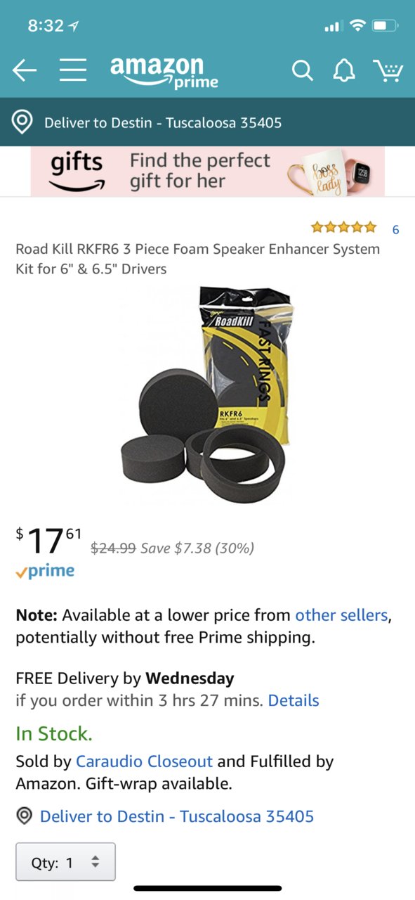

    Road kill fast rings (the ones I prefer, 3 piece kit) are $17 on Amazon.
    I have used just the front ring as well as the full 3 piece set. It’s a pretty good improvement in mid-bass when you use the full kit. And for $17 for a pair ($34 for the whole truck) it’s absolutely worth it.

    Exactly what I bought. Thank you! Looking forward to this work in progress.
