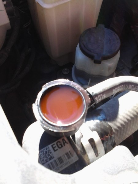

    Discovered this today while changing the oil on my 2011 TRD OR, 4.0L. See three photos.
    I was pretty shocked and worried at first sight. But the oil from the drain pan looked normal, not milky and I didn't detect any oil in the radiator. Truck seems to be running fine.
    I am pretty vigilant about maintenance and always change the oil and filter myself. 5W30 full synthetic.
    Should I be concerned? What causes this?

    It is just moisture build up. Nothing abnormal but.... looks like it's time to flush the radiator unless that just clean Toyota red. Hard to tell.

    Good to hear. I'll keep an eye on it. Yes, coolant is clean red. Thanks.
