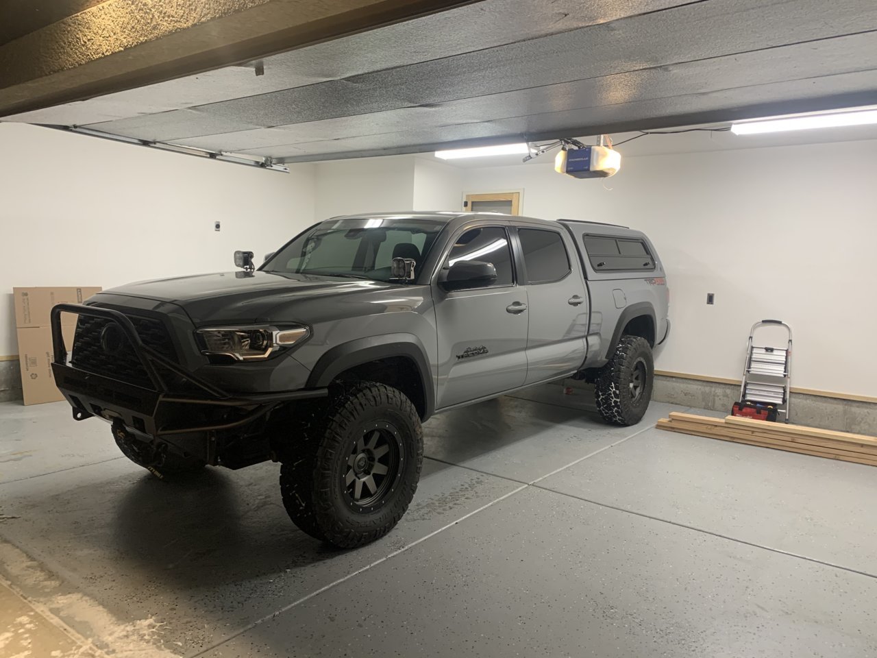

    Can't really help ya but gawt damn that's a good lookin truck

    Thanks bro, now if I could just warm it up via key fob on these cold Colorado mornings. haha
