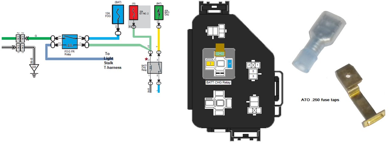

    Hood Struts, My version Fogs always ON, Map & Overhead Light Mod,
    Fogs ON indication in Combo Meter still function...
    Option to have IGN source power the relay coil side tap from the Towing Battery Charger Relay tap.
