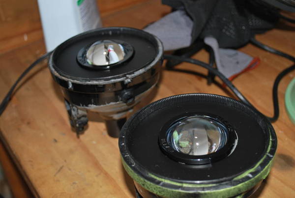

    Here's the write-up I did a while back, complete with the kit I used and prices. I spent $185 on my kit complete with gattling shrouds, projectors, HID bulbs, ballast and wiring harness.
    http://www.tacomaworld.com/forum/lighting/187831-fog-light-retrofit.html
    The Blazer projector has since been discontinued although can be found on some websites. I'm not sure if TRS has replaced them with a different model or not.

    I put my retro's (TRS Blazers) inside the stock housing, 3K.
    It was pretty time consuming but worth it in the long run.
