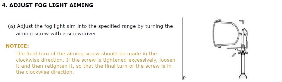

    Ok, having trouble aiming my fogs.
    Which direction do I turn the adjuster wheel to lower the beam if you are laying on your back in snow and gravel looking up? Counterclockwise or clockwise?
    I have searched and read here and other places and have not found the answer.
    thanks

    I was having the same issue and I found this document.
