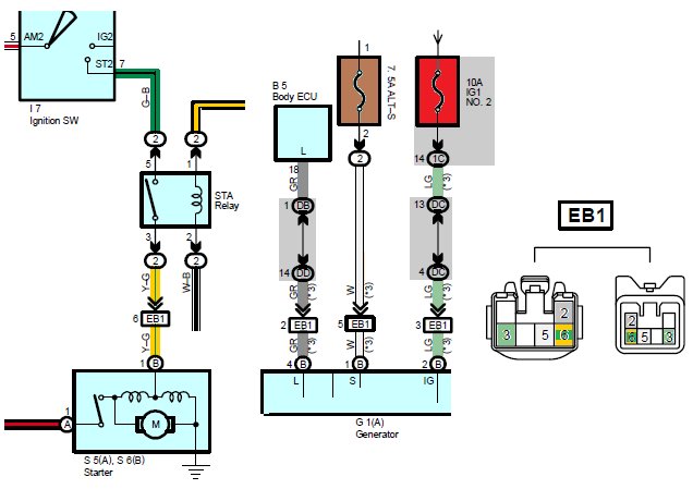

    I recently preformed the fog light anytime modification. Afterwards, whenever I actuate the headlight/ turn signal stalk my ABS light turns on in the dash. Has anyone else experienced this?

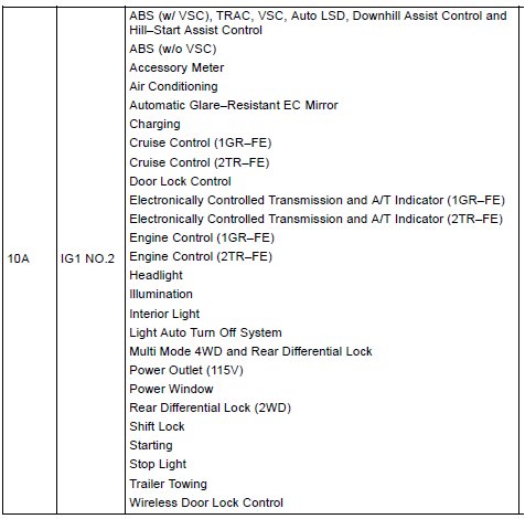

    I really don't know what I'm looking at....

    I double checked and I did connect to the correct wire (the light green one)

    You know that Green wire you tapped into?
    Take a look at what fuse it goes to.
    Then look at the list of things it goes to above.
    It goes to the the ABS.
    He’s telling you, “Start there”.
