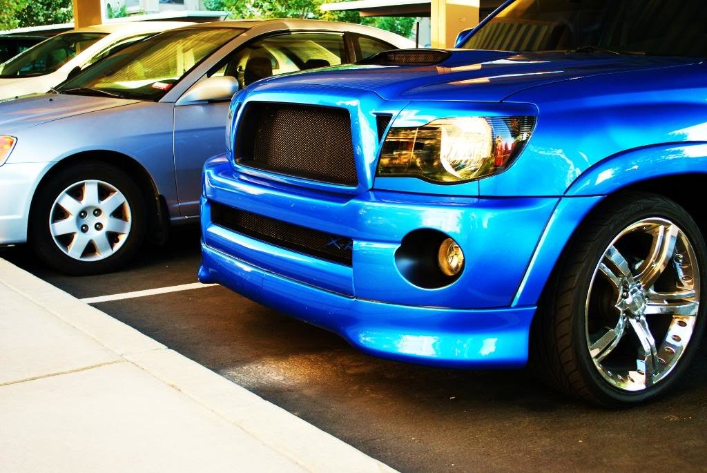

    used "plasti dip" to paint the area black around the fog lights.

    I like it, goes perfect with the black headlights
    and I really like your wheels!

    Great job! Looks great!

    I like it I had thought about doing that to mine but wasn't sure I'd like it with my yellow lens

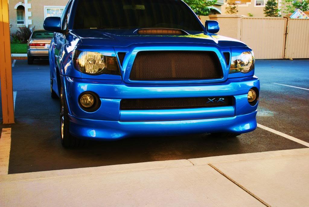

    did you make a custom grill for the bottom part on the bumper as well as your satoshi?

    i just cut out the center section and used the mx lower grill and recesssed it

    here's a quick write-up:
    remove both fog lights and clean area to be painted (i used simple green)
    tape off edge off fog light area ( i used some very thin tape that i bought from a hobby shop, it looks like pin striping.) then some wide blue painters tape around the thin tape.
    1 can plasti dip, spray one fog light area at a time. as soon as you are done painting remove the tape, if you let the plasti dip dry and then pull off the tape, the paint will come off.
    according to the directions on the can, dry time is 4 hours.
    enjoy!
