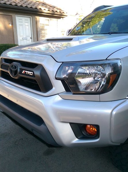

    http://[URL=http://s349.photobucket.com/user/kabory/media/Mobile%20Uploads/a8c2055a-9013-4186-9087-c3801925e83c_zpsul2sztrn.jpg.html][ATTACH=full]2059638[/ATTACH]only issue was removing one of the blue clips. It flew somewhere, after an hour of searching, I went to dealer to buy a new one. Parts guy didn't know what it was. I thought that was weird.

    Dry. Work from center out. Few creases at edges but they came out just by rubbing. Lamen x is pretty flexible. If you have to reposition it, don't touch backside with fingers or it will leave fingerprints. Remove your fog light bezels, it's much easier. You don't have to cut off the lamen x tabs. I didn't. It's pretty easy install
    Good luck
    Ps. Be careful when removing the blue clip on the back side of bezel. I lost one somewhere. No worries though as they only cost 1.92 ea at the dealership

    Much appreciated. Working on it as we speak. Thanks.

    Done and done. Thanks for the help.

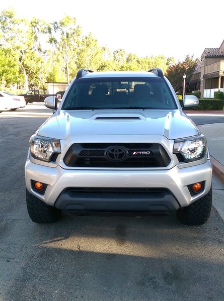

    It's the stock 2012-2015 Tacoma grill with a plasti dipped Toyota emblem and I added a TRD emblem as well.
