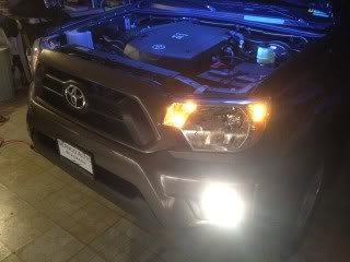

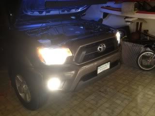

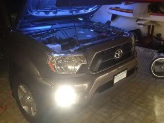

    I wanna thanks the dudes that helped me out!! Green wire tap!
    DB506FE6-0128-472B-91F6-01062FC0AE23-457_80b728d6c32820b06e910a8f0332cad190a1025b.jpg
    566349EA-4AC1-4593-87C6-0F4F08AB10EF-457_0c447c89667704a399786ca7438c612bbea9949a.jpg
    319A6BCD-8A78-4D82-A925-D2A83C262181-457_0cb0599f7e7b7976ab4961d6a7e5b8c6a918a1ba.jpg
    GREEN WIRE TAP!! FOGLIGHTS ANYTIME!!
    ... Now I'm thinking how I can install my old fishtank blue actinic bulb in under my hood, cuz that sucker looks sic!!
