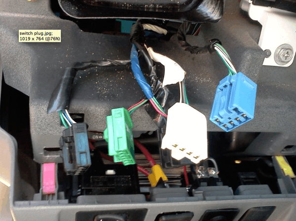

    I recently bought some fog lights for my 06 prerunner and under the hood it looks like it would have the harnesses to run them. The wires fit in the back of the fog lights. But in the cab i don't know which harness would be the one to hook a switch to. :confused: Any help would be helpful

    Top left. And did ya get a relay

    Pull out the blank switch (top left) see if there is a wire. It's a Prerunner so should be prewired. Then you will need a relay. Where did ya buy the lights? eBay? If so the switch may not fit.

    I pulled all the blanks out and didnt see any wires. This was there. [​IMG]
    I did get them from ebay.

    Black should be the fog... Blue is the dimmer
