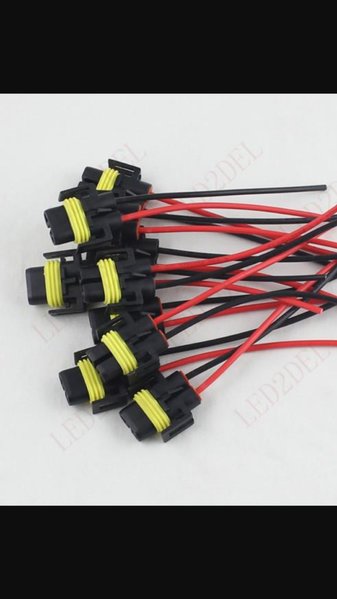

    @TRD Fisher they're just two wire clips, I added some lights to my truck and wanted to use the same waterproof clips so I cut them off an old hid kit. Attached those
    Are these what you need

    Correct it is an H11.
    It is the female end that connects to the bulb. The one above is the male end that connects to the harness itself.
