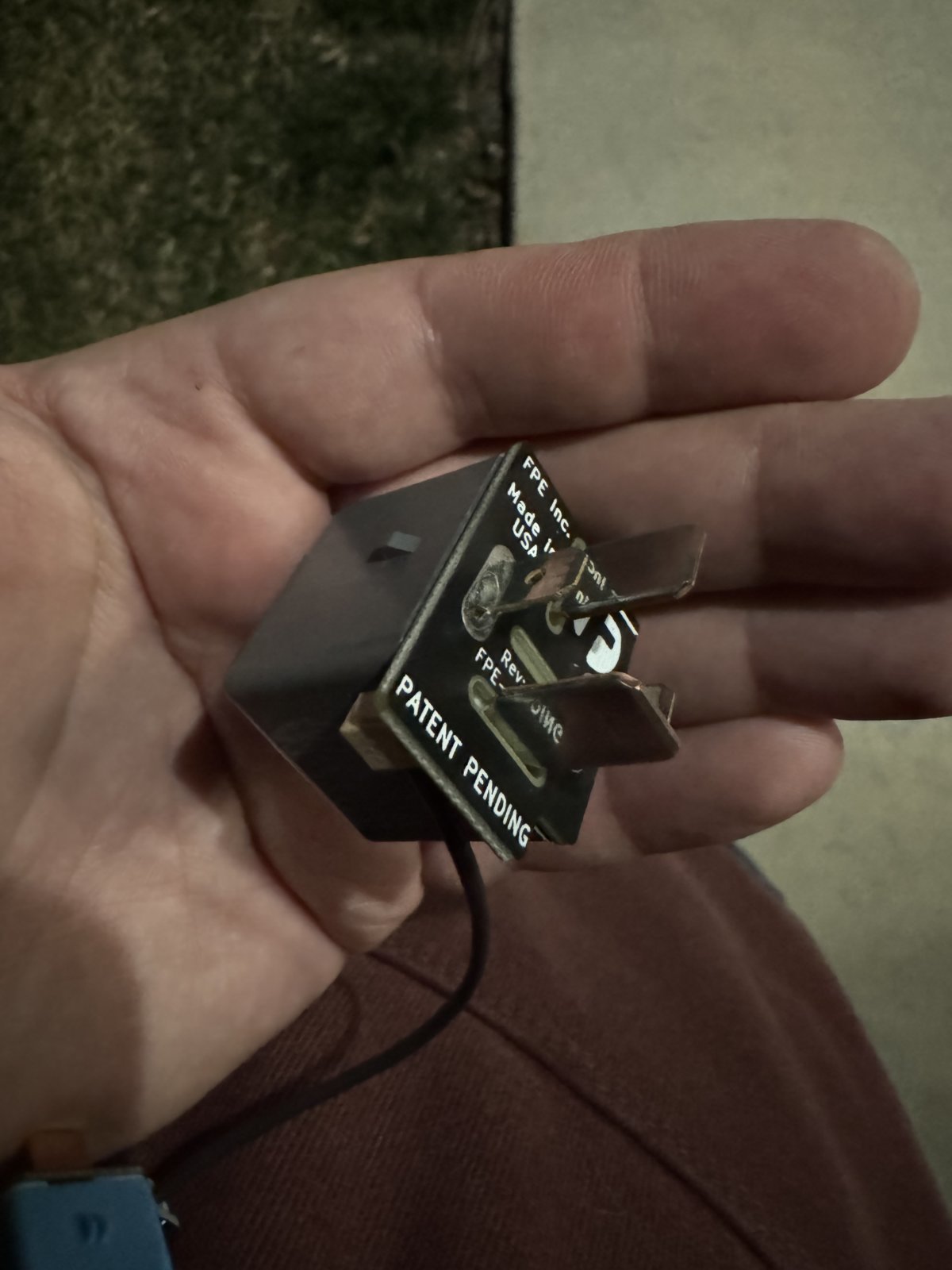

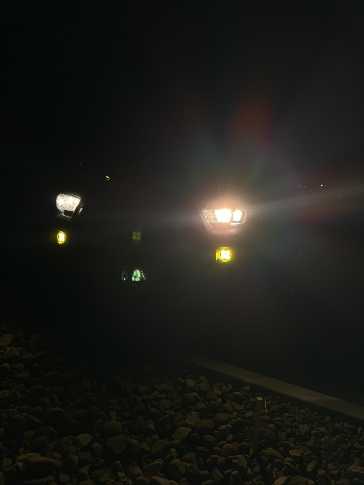

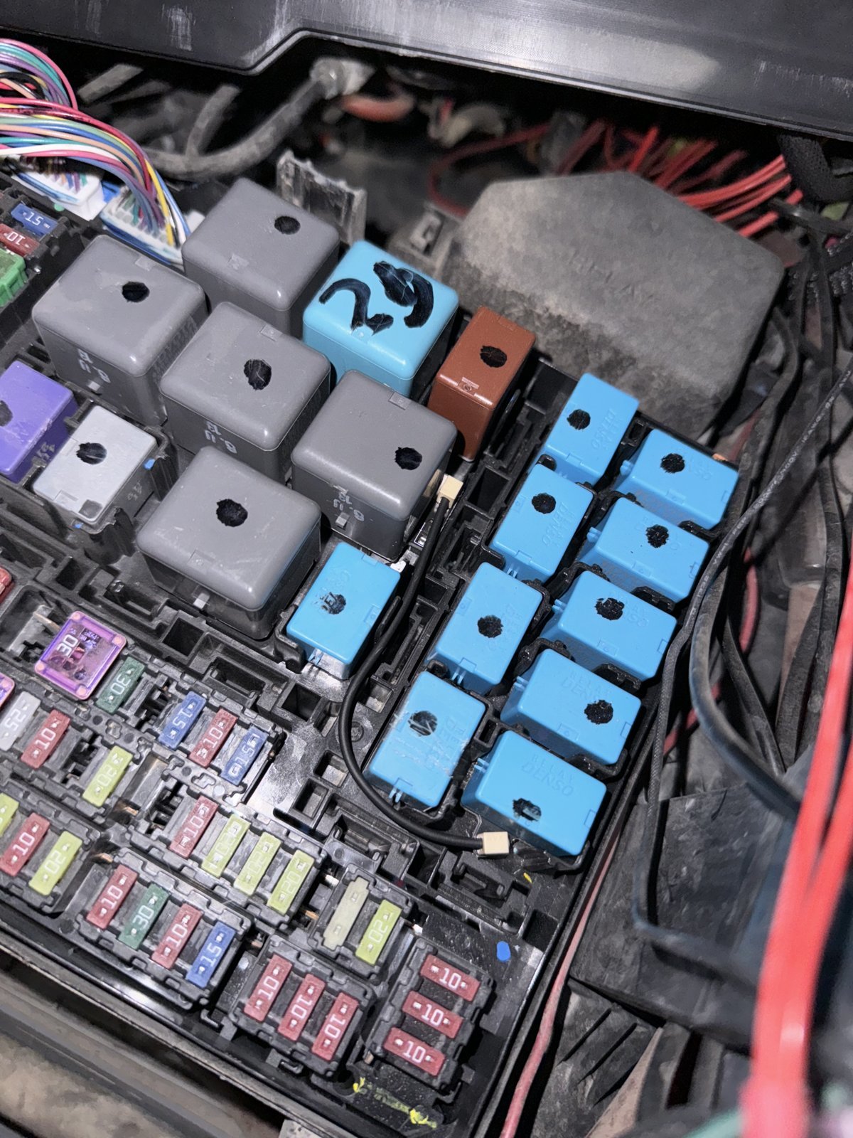

    Got them installed! It does only take a few minutes. Longer if you install them upside down like I did the first time :rofl:.
    Make sure and install it with the patient pending face side down and the little white box where the wire goes into on the top - per the instructions I just didn’t read lol
    Quick youtube video showing them working.

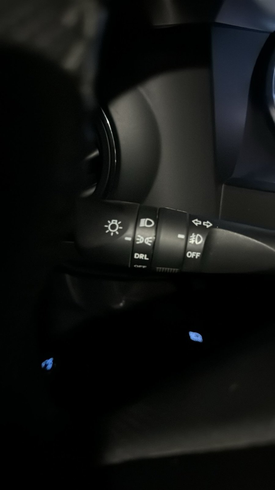

    No sir. And to avoid any further confusion from folks a quick rundown of the stalk below (this is on a 2020 non-LED truck).
    Off - No fogs
    DRL - No Fogs
    Parking - Fogs will work with stalk switch as desired (on or off)
    Low Beam - Fogs will work with stalk switch as desired (on or off)
    High Beam - Fogs will be on
    429481077_936136854814251_38846007089077_df8fd5c8abd8708609813912bb4653c99479e51f.jpg
