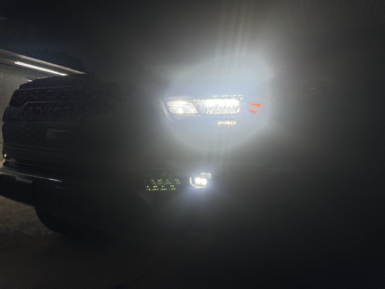

    Installed this morning before I left for work. Don’t be a dumbass, like me, and try
    installing it upside down. (Sorry for the bad pic, glare for a quick pic was bad)
    Working great on full LED!
    Can see great on those back roads.
    Thanks Colton!

    Working on full LED!? Woot! Were you originally full LED or are you a conversion? If you pull the stalk back to “flash” someone does that function work?
    Sweet!
    Just keep working it back and forth! Sometimes a big pair of pliers will help. You won’t break it as long as you don’t try to force it in one direction all at once.
