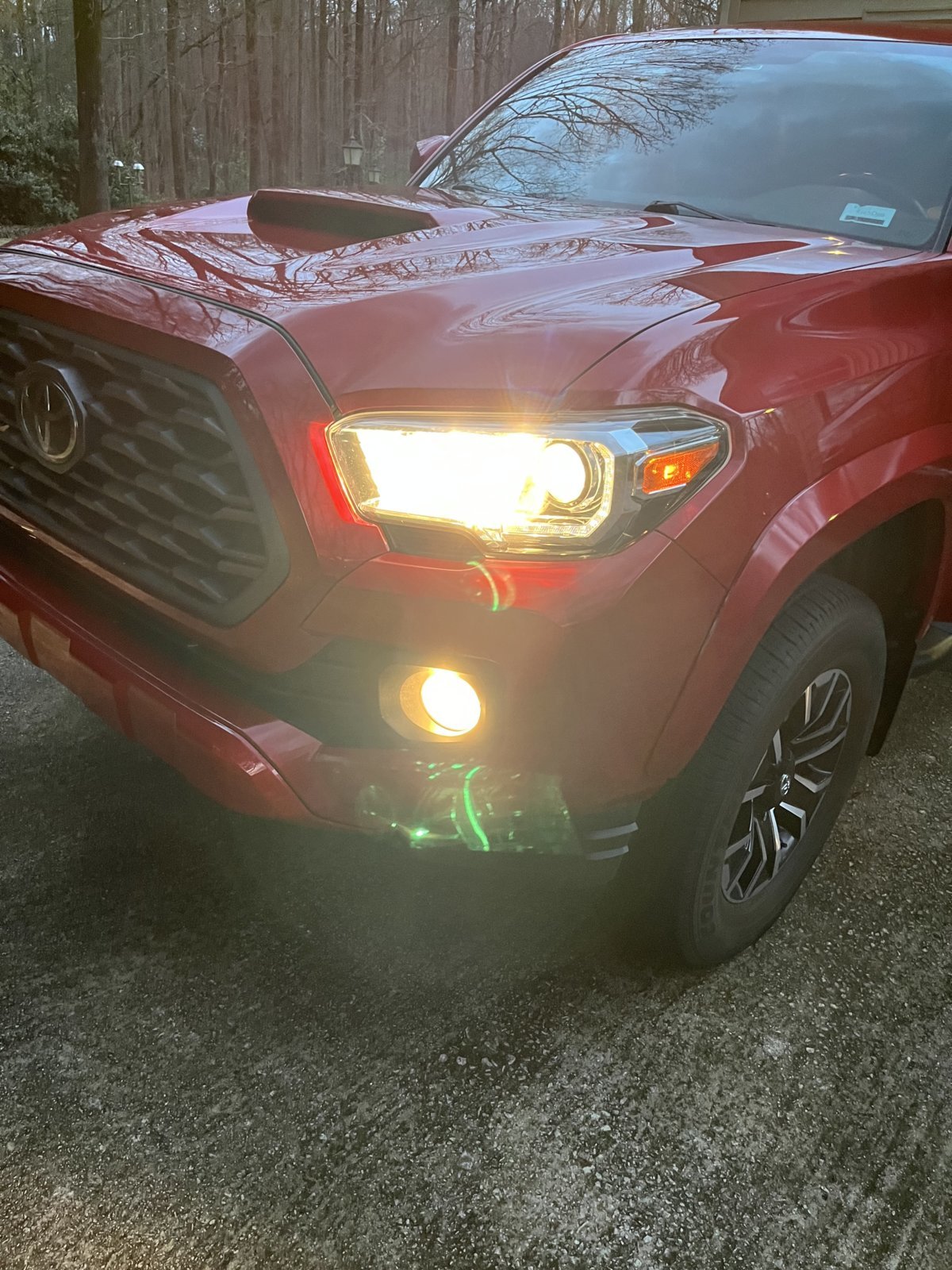

    Received and installed. Thank you @memario1214 Colton!
    Very straightforward installation and works as advertised on a 2020 non LED headlight TRD Sport.
    I do have pliers for relays…:D
