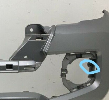

    the piece thats circled, where the screw to hold the fog light assembly in place

    Can you use a slightly larger diameter screw? You might have to JB weld or both. :notsure:

    My thought was to use the JB weld to fill in the hole. Then after it dries try inserting the screw so it has something to grab or bite onto. Obviously if you place the screw in the JB weld while it's drying you won't be able to remove it.
