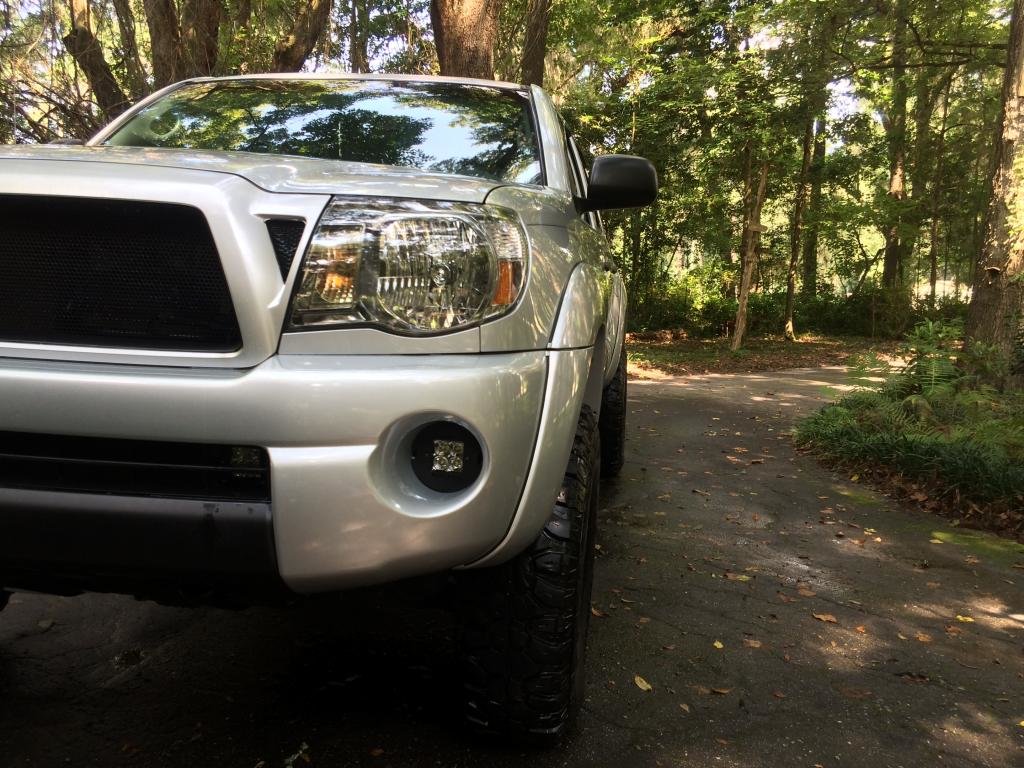

    They have to be recessed some in order to mount them. Here are what mine look like. I used a fit kit for a tundra before they had one for the tacoma and modified it to work. For wiring I cut the Rigid harness behind their weatherproof quick connects and connected it straight to the factory fog light wires that went to the stock lights. That way I maintain the stock switch in the cab.
