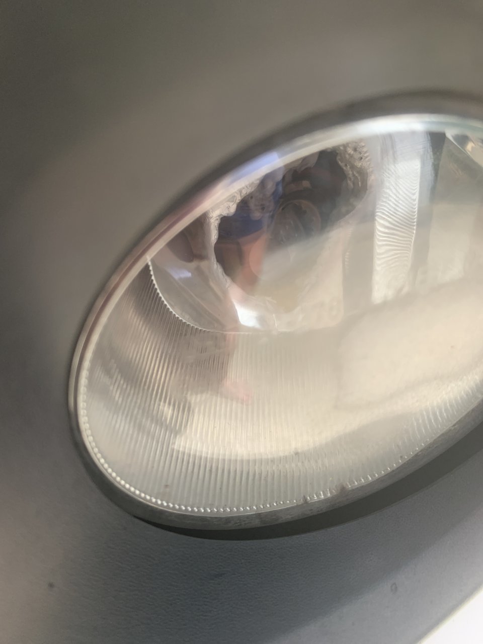

    image.jpg Anybody know why this happened. I bought it used a month or two ago, but I never noticed it. The light still works but I’m not gonna risk it. Wondering if this has happened to anyone else.

    LED replacement bulb and possible cheap aftermarket housing?

    Or just wrong bulbs in there.

    You can usually get OEM fog lights for a cheap price in 3rd gen marketplace, just verify that they’re H11 fogs

    Does that also include the housing?

    I got a pair of like new oem H11 fog light housings with the bulbs for around $50 bucks there. People take them off to install other aftermarket fogs. Didn’t include the trim covers since I have an SR I bought those separately but you already have those.

    damn. gotta be the wrong bulb because those housings are stock

    Wrong bulb.
    I have a set for 55 watt bulb to give away for free..
