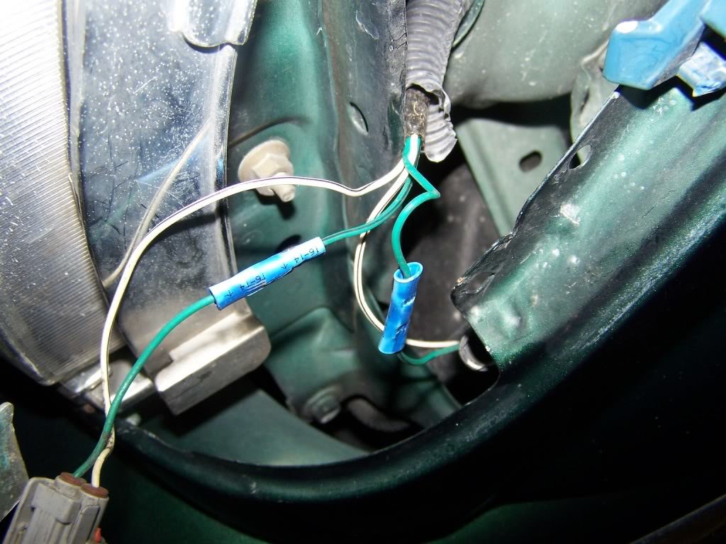

    Okay, you remove the corner light and there is a harness going to the corner light and another going straight down to the front turn signal, you strip away what loom you need and cut the green wire that goes to each light, then swap so the green that went to the front signal now goes to the corner light and vice versa. You will need to get a LED resistor to make your signals blink normally or let them be and they will blink fast. What you get is your front turn signals are now fog lights and your corner lights are now turn signals, you should also switch bulbs so they are white like the headlights and in some states you may be required to change the bulb in the corner light to orange. Here is what it looks like
    on my driver side one green was indicated by a black stripe as you can see, on the passenger side the greens were noticeably different shades.

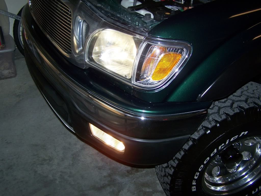

    Just one...

    Looks awesome. How easy was it?

    Once I got the tape off of the loom, it was easy...it was just time consuming to get the tape off (for me anyway).

    seeing as that lense was never meant as a fog light, i'd be interested to know how it does.
    can you get a pic at night from the drivers seat looking foreward with them on ...and then a pic with them off?
