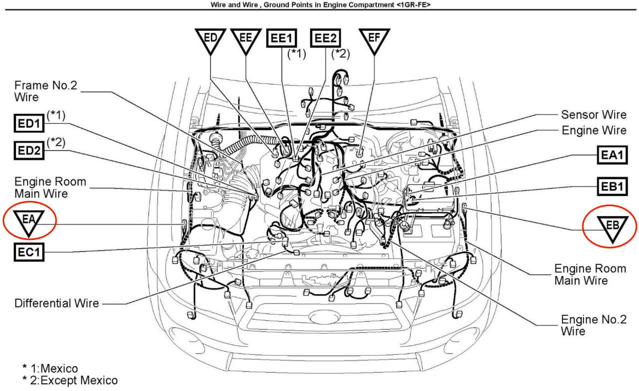

    The wiring diagram for the foglamps on a '15 Taco show them being grounded at points EA and EB, respectively. Check those points, make sure the ground is clean and tight.
    DoulosXP and dlawrence529[OP] like this.

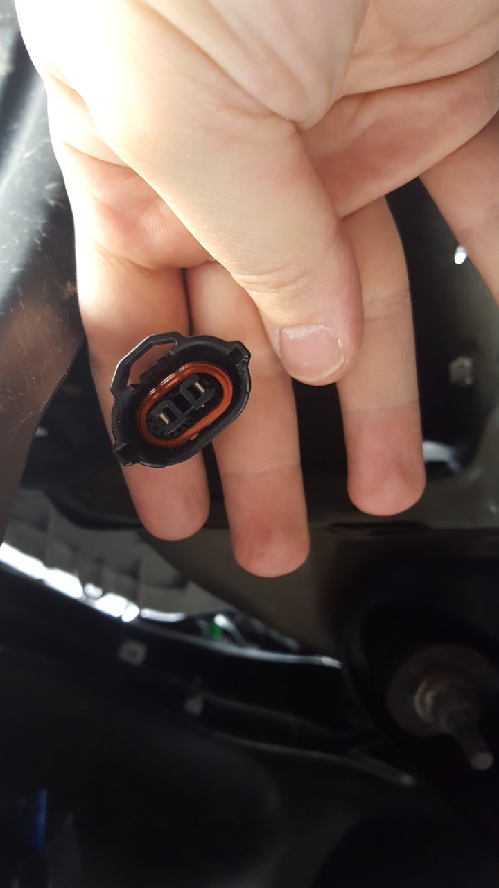

    Also check the terminals in the foglamp bulb harness connector, make sure the terminals haven't corroded or been pushed back, or spread apart.
    dlawrence529[OP] likes this.

    I put a wrench on the grounds and they are tight. The terminals seem clean. The connection seems tight. When i put my meter on the terminals it is reading 6.5 volts. Any thoughts on where to go from here?
