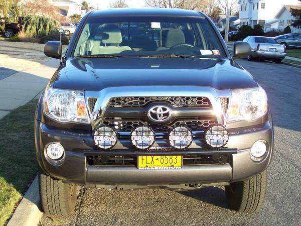

    n-fab bar with 4 6"piaa 520's[​IMG]

    I've got the same set-up, 4 - PIAA 520 driving lights. I found that mounting fog lights on the light bar makes them ineffective (too high).
