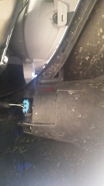

    2016 4Runner TRD Pro
    Alright, starting with the driver side fog light, you're going to look behind the drivers side bumper and see the above picture. Where the arrow is pointing is one of the mounting "lugs". There is one on each side of the fog light. Push that "lug" in while pushing the foglight out of the bumper. There will be resistance but the bumper will flex enough to get the foglight out. Repeat for the passenger side.
    Hope that helps.
