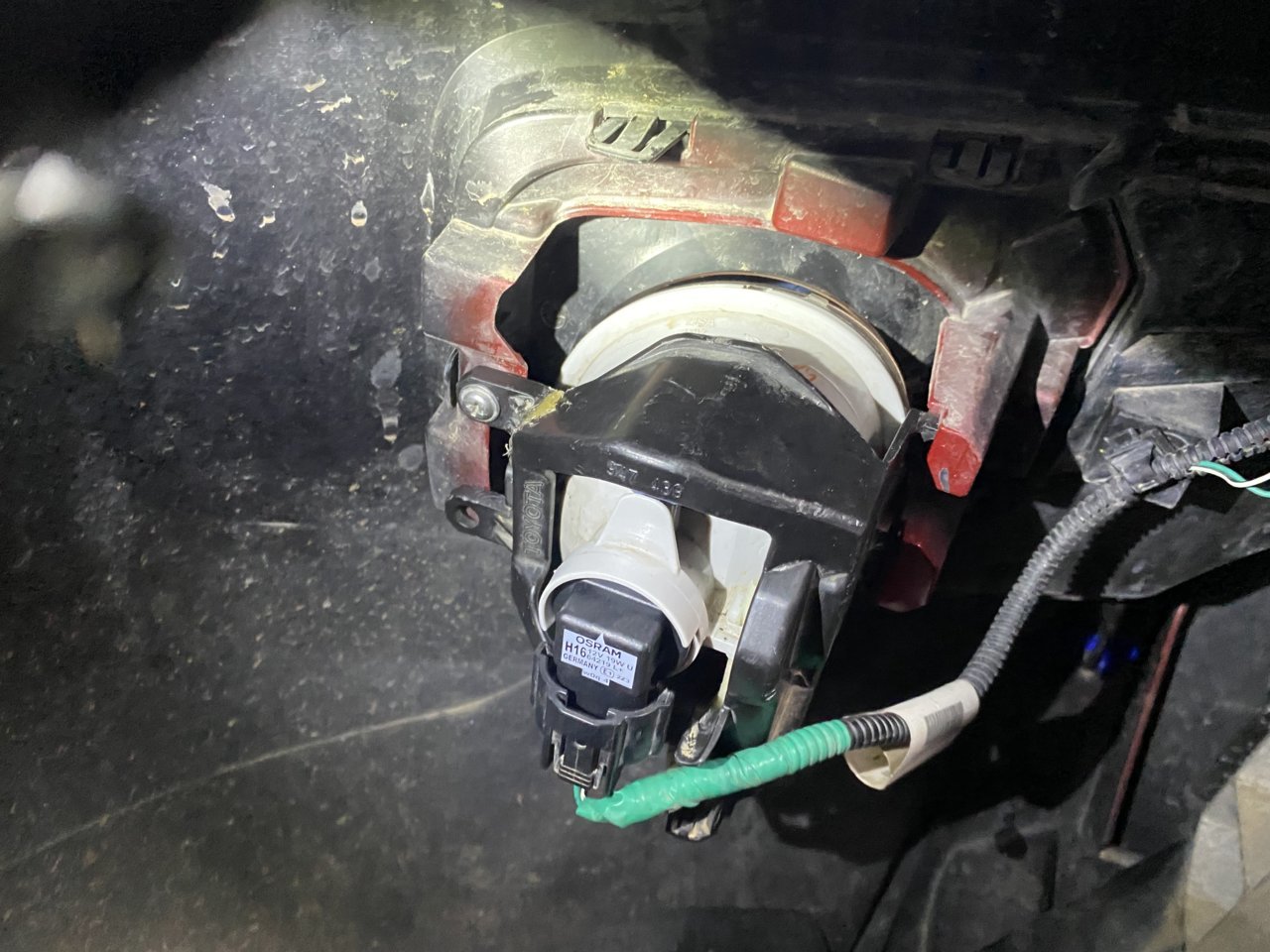

    Just to close the loop here, I ended up using some Loctite epoxy for plastics to reattach the mounting tab with the screw. It worked a treat. I was lucky it was a continuous break that fit back nicely and lucky that the mounting tab took the damage (no cracked lens or other damage).
