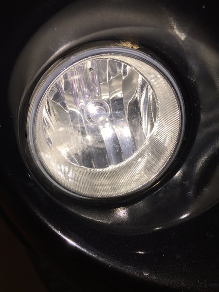

    So basically there's not really an easy way. I may just pick up the kit and see what the results are. The fogs are hazed in a weird location. It's more severe in between the center and outer area of the light. I'll post pics when I get the chance.

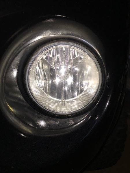

    Here they are. The flash kinda makes them look worse than they really are.

    You could get those looking really nice. They're not too bad at all. You could try PlastX on a cotton terry towel, followed by a microfiber or foam pad. The PlastX might run you $8 locally. It takes some time and elbow grease.
    People seem to underestimate the time it takes. Think about it-- it's a micro-fine abrasive (almost like toothpaste) and you're abraiding very hard plastic. People get owly when they think they're gonna have clear lenses in 5 minutes by hand and it doesn't happen. And then they say PlastX sucks. Well, it's not magical like that. But it does work well with some time and effort.
    Conversely, I think you'd have it knocked out pretty quickly with one of the meguires kits and cycling through their abrasive pads. I'd be getting a kit with the drill attachment if $$ is no object. But honestly, I think any of those kits would get you to where you want to be. It's just a matter of how fast you wanna get there. Get a kit, set aside a couple hours, and you'll be set.
    You know how you can see swirls in new plastic lenses after just a couple wash/dry sessions? Kind of like swirls in paint from towel drying-- Those fine hairline scratches come out of lenses in two minutes by hand with PlastX. But as I've said, the haze/fog takes more effort. On the up side, your lenses should clean up nicely.

    Also-- before you start. Look VERY closely and verify that the problem is in fact on the outside of the lens. We just got done working on my brothers hazy 4Runner headlights. Worked for about an hour before we realized that a majority of the hazing was on the inside of the lenses. Just something to watch out for before you get in too deep.
