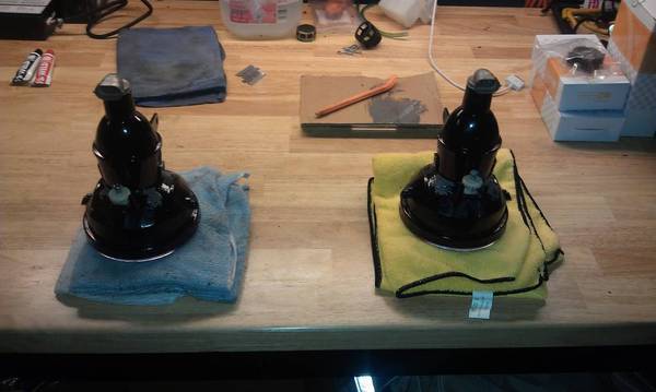

    That's good to know, they've only been on for a total of maybe 10 minutes. When I get the second one installed and the heat sinks in place I'll run them for a while so they get that color shift out of their system. So far the first one is holding up, no water in the housing and looks great!

    I think the blacked out bowl and color matched shroud would have looked much better. By the time I figured it out though, I had already JB welded the first shroud in place so too late for me. I think it would have looked sick with a black bowl and white shroud :(
    Oh well, maybe my next set... :spy:

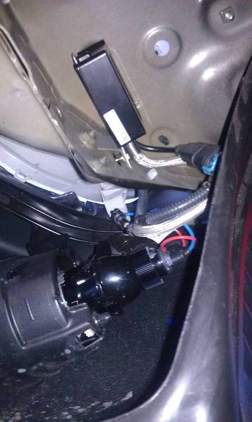

    Looks good! Is the ballast open to rocks from the tires there? I bolted mine to the front of the sheet metal using the factory bolts that insert into the welded on nuts (next to where your ballast is). Also, I don't know if it's necessary but I used thread locker on the screws that hold the ballast to the mounting plate.
    How's the light output? I still only have one of mine mounted so I haven't messed with alignment yet.

    You have a good point, didn’t think of that. I will probably mount them on the other side for better protection. I will post some pics in the morning of some output shots once I get out of work. I currently am running 3000k bulbs and don’t really like the color with 4300k headlights so I think am going to order a set of 5000k's from TRS.....
