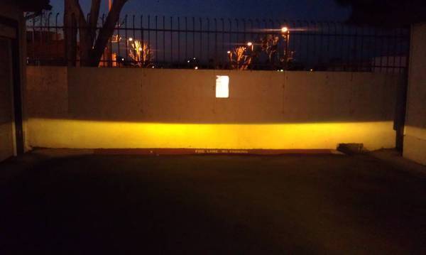

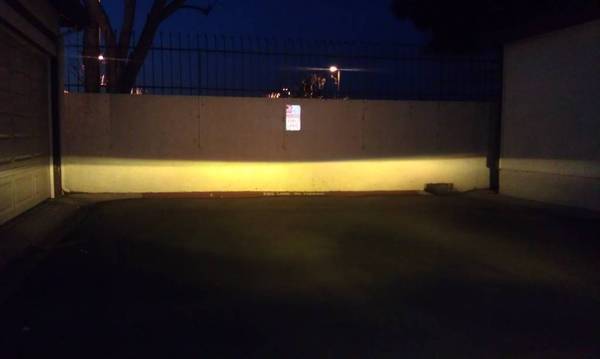

    Okay I got the 5000K bulbs in with the wire down. I am happy with the results. I prefer it over the 3000K. The only thing I dont like is that the cut off line is not as sharp as with the 3000k, not sure why...:confused:

    Interesting... I'm trying to talk my dad into letting me install a set of these on his truck and I'd use the 4300K or 5000K. That's weird that the cutoff was affected by the bulb color.

    If you look at the right side of the beam it gets blurred against the wall.Not sure if the reflector bowl in the fog light has anything to do with it. Overall, I am impressed with the blazers. Definitely good bang for your buck! I am going to try to find a better wall to mess around with to make some more adjustments…

    I don't think it's the reflector bowl because my cutoff blurs at the sides also (and I don't have any reflector bowl left to reflect light). I think it's just the relatively cheaper projector. The higher end projectors would (should) have a cleaner cut off, wider beam and no blurring at the cutoff.
