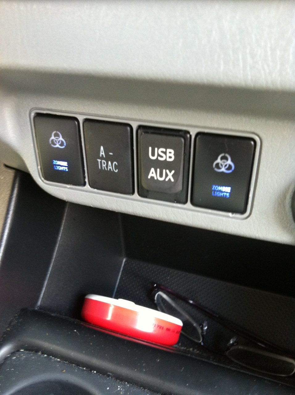

    These blanks just popped right out and the new switches just popped right back in.
