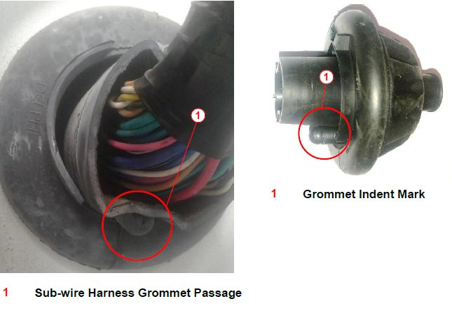

    I have some fog lights for my bull bar and looking to wire them up this weekend, but looking to see if anyone has a tried/true/easy way of routing the wires through the firewall.
    All recommendations/suggestions are welcome- pictures a plus!

    There’s a rubber boot on the driver side fire wall.

    There's a nipple under the large main grommet, cut, route the wire then seal...
