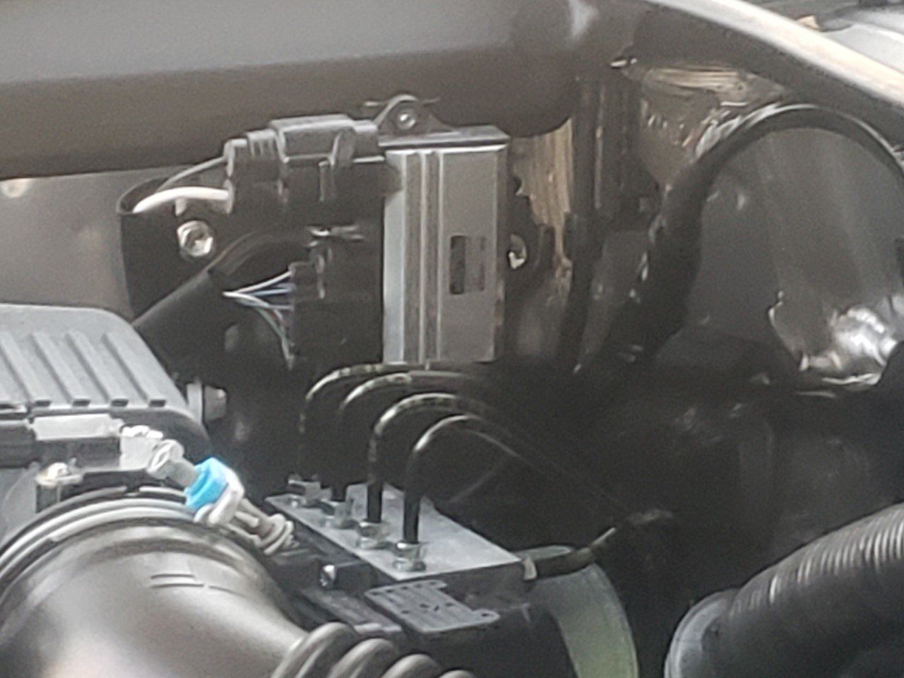

    Well, the internet provided a picture of the actuator but not the location of it. I have no clue.

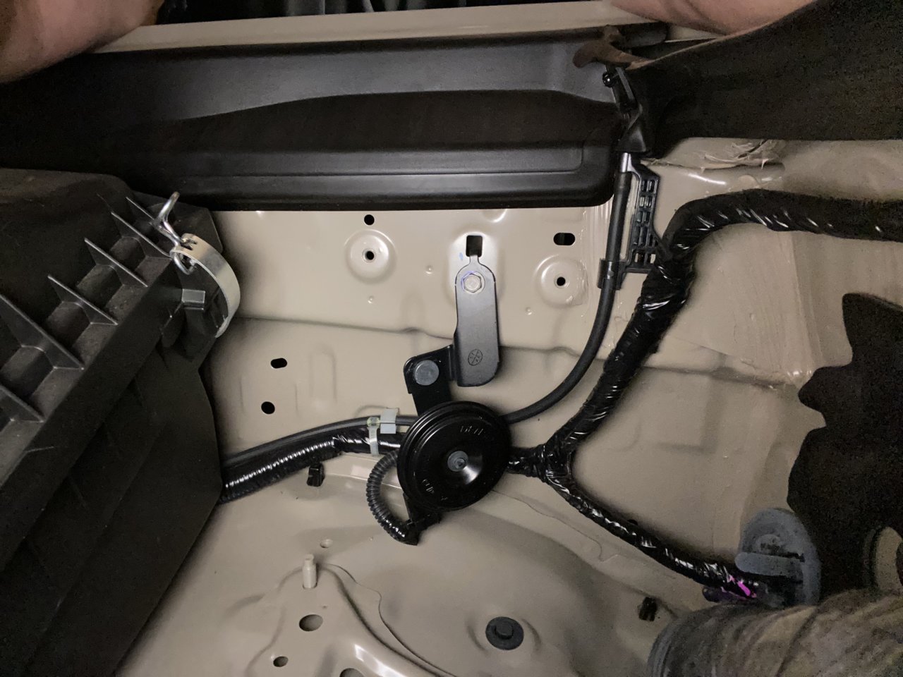

    05 PreRunner TRD Offroad AutoTrans
    Hood Struts, My version Fogs always ON, Map & Overhead Light Mod,
    there's a drawing I posted. Passenger side on the fender, engine intake then Anti-skid actuator module, next to it. It looks like a VW horn.

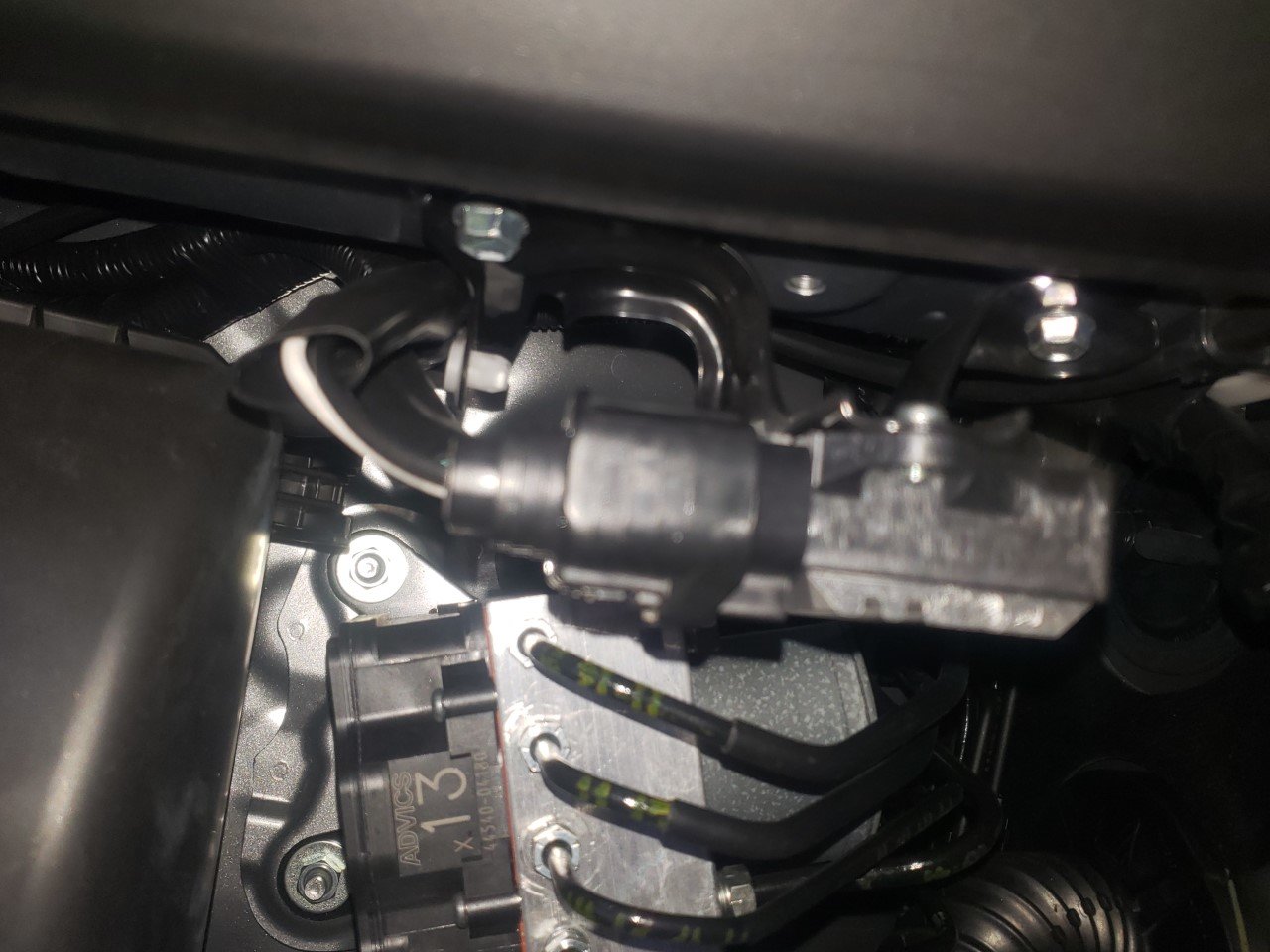

    No, I didn't see a horn. Not sure if the pics will help but...
    Your TACO doesn't have it, but the connector is most likely there.
    The ground is the metal frame that secures the horn.

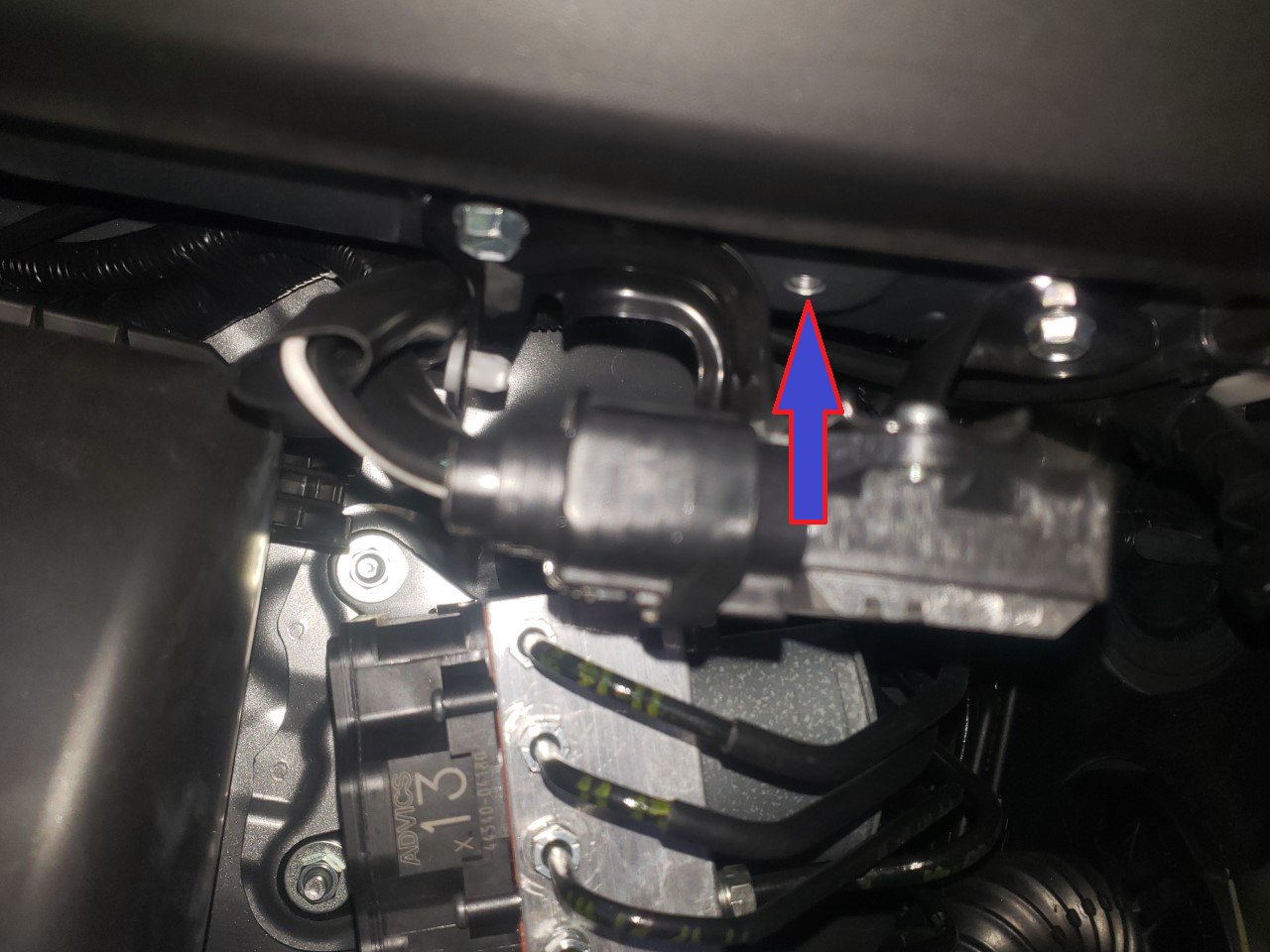

    Securing bolt hole on fender.

    So, I'll use that location as a ground if I install a fog light switch correct? If I change out the signal stalk to the version that has the fog light switch on it, is there still a ground that needs to be done that way or does that new stalk take care of that?
    Nooo.
    Swapped stalk has a ground already to the vehicle harness.
    Disregard the info on the missing buzzer.
