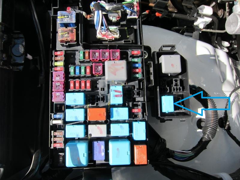

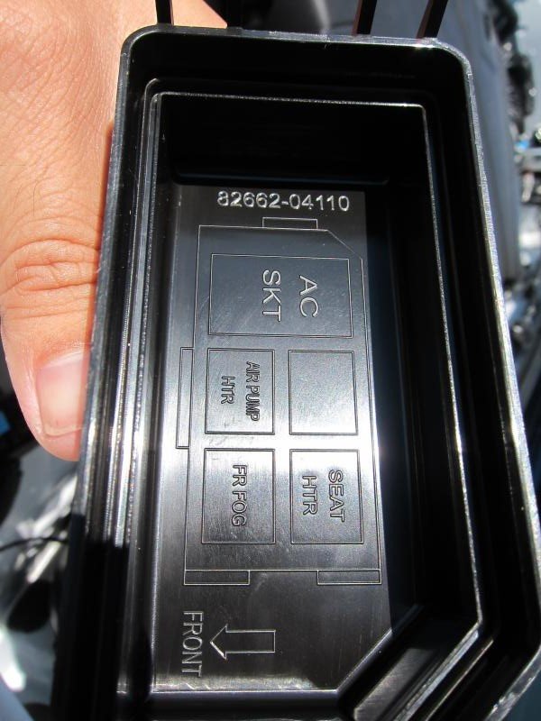

    Maybe the slot is in the auxiliary box (smaller) next to the main engine fuse box. I can't recall when they changed the location of the relay.
