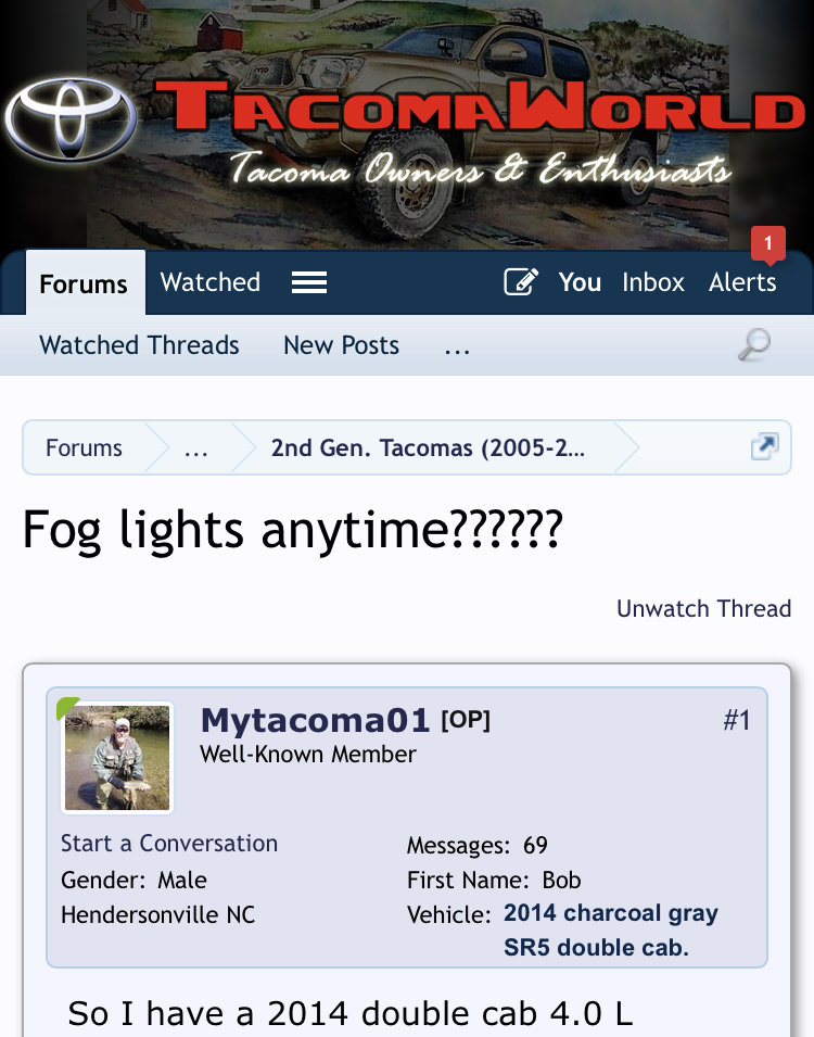

    What is the name of the post?
    Like what does it say up top?
    This is what your post is called.

    “Fog lights anytime mod” is the name and the link is given in the 5th response into the thread. That’s the link I used.
