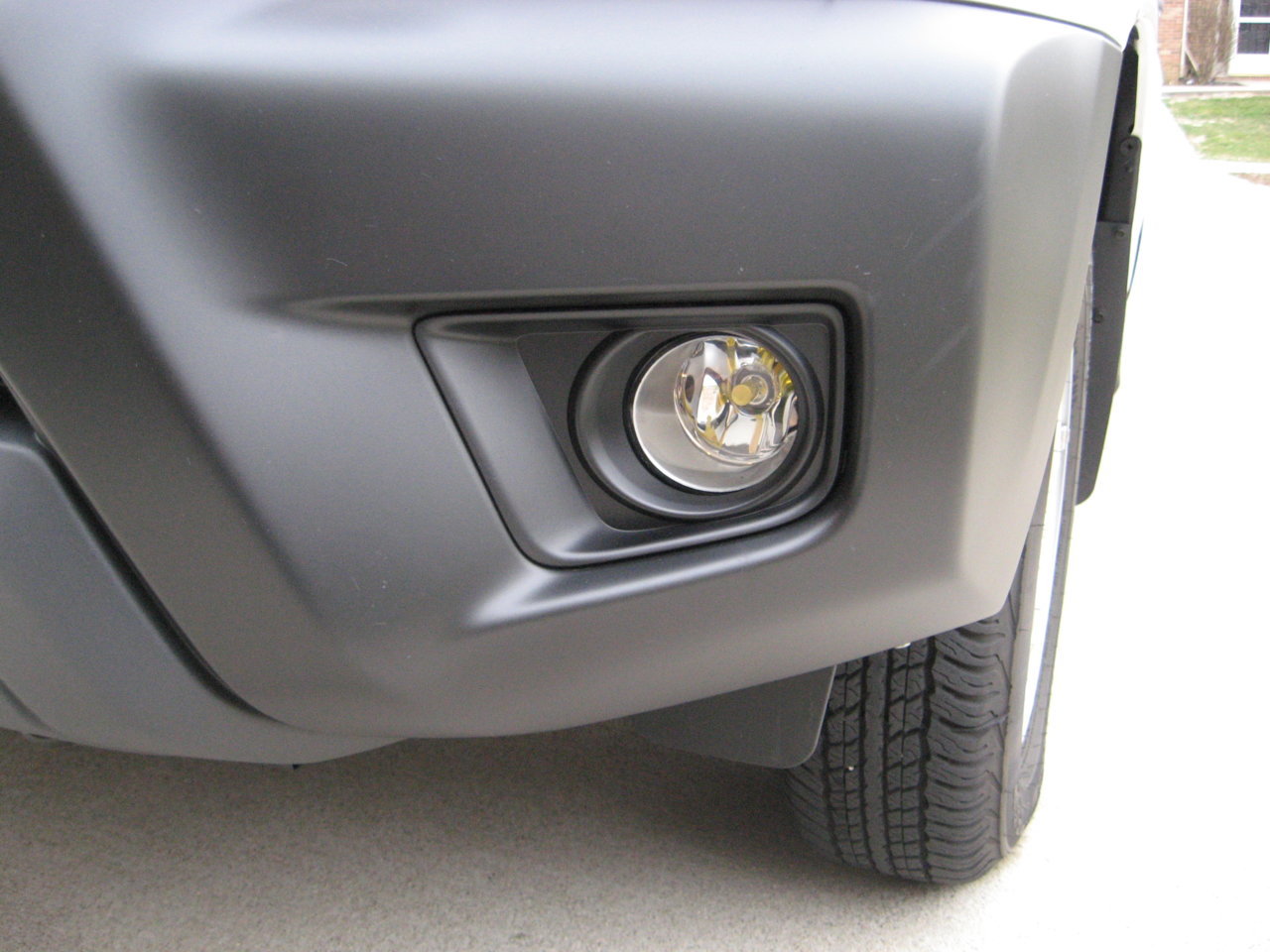

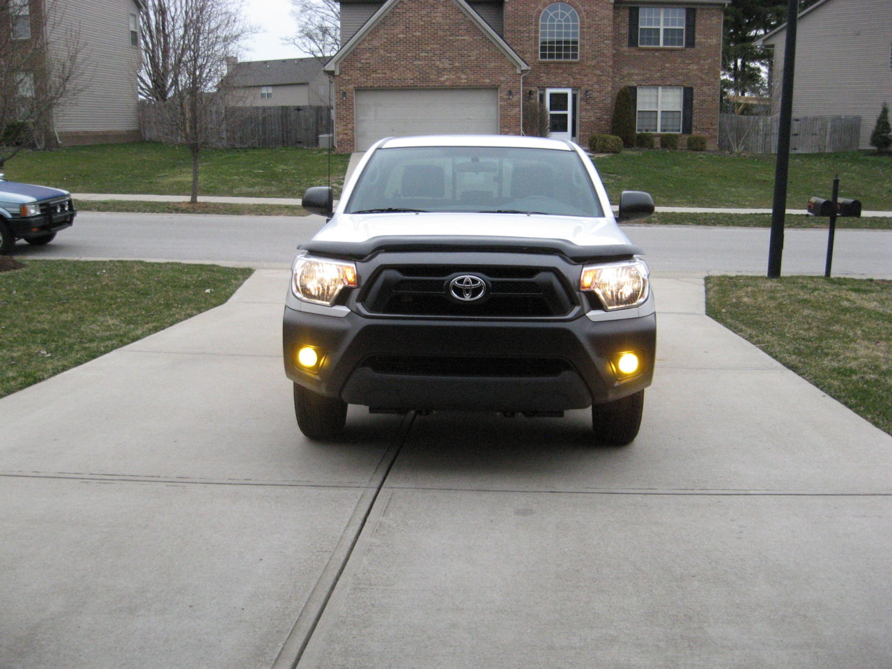

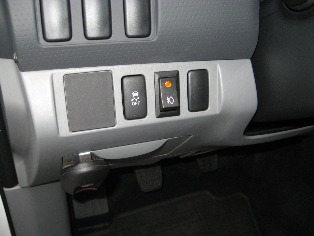

    This was done about 6 years ago and I no longer have this truck. But the lights are just a cheap Ebay kit. The fog light blanks don't pop out, they unbolt. I recommend using those screws to secure the lights as they are probably of a higher quality than the ones that will come in the kit.
    Most of these kits come with a generic wire harness and aren't truly plug and play. Some modification is necessary. I didn't like the switch that came with it. So I gutted the harness of anything related to it and ran an old OEM rocker switch from a 90's era 4Runner that I had had unopened for many years.
    The lights were powered off of the battery and the relay was switched from a blank spot in the interior fuse panel that was hot when the parking lamps were. So the fogs came on and off with the parking lamps/headlights.The rocker switch simply interrupted the signal between the relay and the fuse panel hookup and was only there if I wanted to have them off for some reason.
    The bulbs were some PIAA Ion Plasma Yellows.
    I have very limited picture info as it was several years ago and I'm going off memory. Hope this helps.
