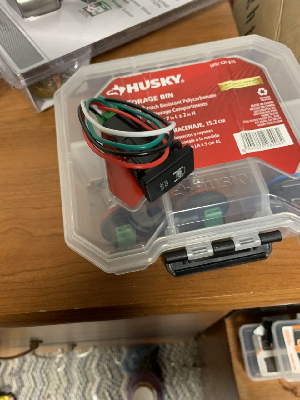

    BF777FE8-DC98-4E62-B512-31529F19030A.jpg I’m guessing the kit came with a relay? You can get one of the smaller oem type switches and connect the relay, ground, and instead of adding a circuit to a fuse, connect it to the switch like this.

    Something I’d probably end up doing, I did not know they came like that

    It’s very easy to install, most difficult part is pushing the wires through the firewall.
