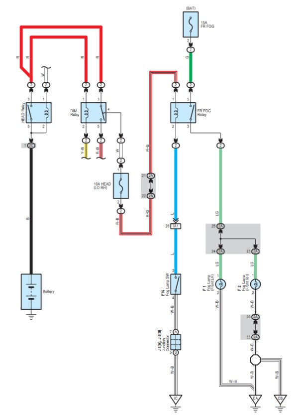

    From the drawing below you can see that the switch is for the ground wire of the relay and it would have to latch on for the lights to remain on. It looks to be a defective switch for the fog lights.

    Thank you, this is super helpful. It looks like that's the first thing I will try. Cheers!

    The switch illumination is separate from the fog light power.
    The switch is illuminated by the tail light fuse and switch.
    This also helps point to the fog switch itself being th issue.
    I think JimmyH is correct.
    I’d feel comfortable throwing a switch in it:thumbsup:
