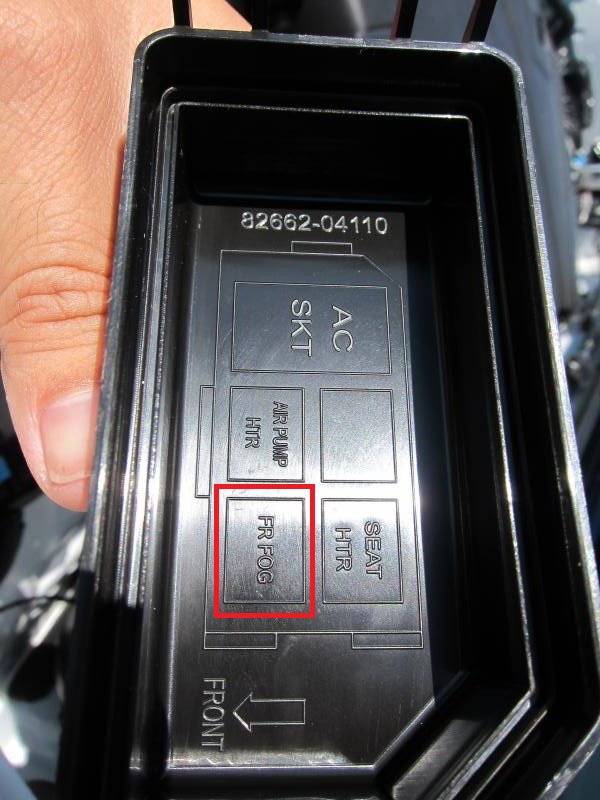

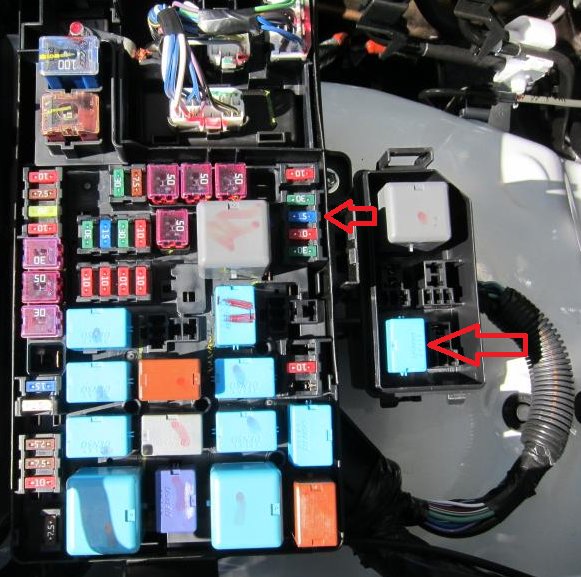

    caribe makaira
    caribe makaira Well-Known Member
    Feb 13, 2011
    #51121
    11,786
    Caribbean, Puerto Rico
    05 PreRunner TRD Offroad AutoTrans
    Hood Struts, My version Fogs always ON, Map & Overhead Light Mod,
    Fog Relay is in the little box next to the main fuse box...

    Fullboogie
    Fullboogie Well-Known Member
    May 8, 2017
    #218539
    1,124
    Dave
    Houston
    2007 Prerunner & 2008 4Runner
    Caribe - you sure about that? I thought it was the relay directly to the left of the 10a fuse in the main box. The one just below the blue relay with two red marks on it.
    Scratch that. I'm thinking of my 4runner layout.

    caribe makaira
    Feb 13, 2011
    #51121
    11,786

    elricfate
    elricfate Well-Known Member
    Nov 26, 2019
    #311771
    870
    2009 Tacoma AC Silver Mica
    Different setups exist, one in which the fog relay exists in the main box and another in which it is on a helper box. Mine is in the main box. Also mine just got to a point where it was sticking open and only a speed bump would cause it to cycle off, so I replaced it. It happens.
