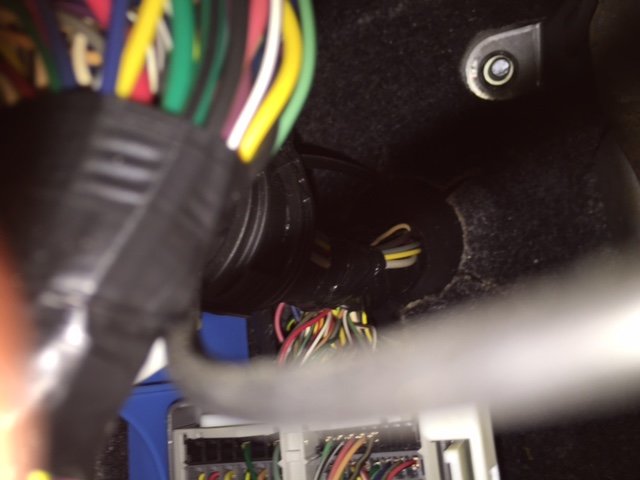

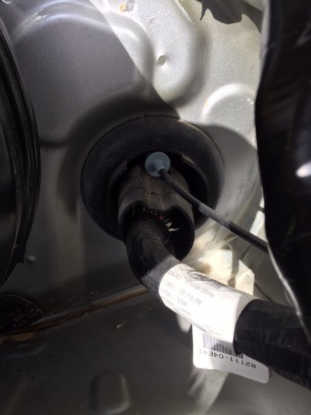

    I ran outside and took a couple of pics from the engine side and the inside.
    Do I run these wires through here?

    Yes, that's the spot. Tape the wire up to a piece of coat hanger and with some dish soap it goes thru easy.
    All you need to buy is a fuse tap to power your switch
